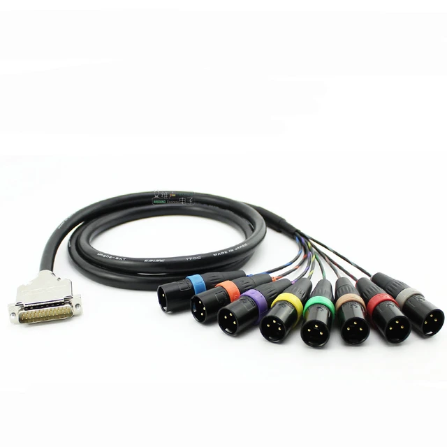

You could buy a cable from Merging or construct one yourself. You will need the pinout diagram.
I have an RME HDSPE AIO card which uses a similar D25 output. Close reading of the manual shows different wiring methods for different applications. In the end, I selected the pinout diagram I needed, and got the pro audio shop I bought the card from to construct a cable for me.
The Hapi has an ADAT (optical) input, so yes. It also has 8x AES/EBU inputs via D-sub, so you will need an appropriate cable constructed for that.
Hateful thing about DS-25 connectivity from DAC output channels for my situation is that makes buying a premade (and probably far from cheap) unbalanced/mostly balanced cable improbable, since I wouldn't be reasonably certain of required the cable length + slack for the subs-or even the mains-during the room correction and speaker placement phase. So that pretty much forces me to get that pin out diagram and make my own cables. Any particular cable make/model suggestions for home made? Belden? Mogami?
Belden/Mogami don't make the correct D25 cable as far as I am aware. You need a breakout cable that looks like this:
You need one with the correct pinout and wiring. I don't know what the Hapi requires since I don't own one, and even if I did I wouldn't know unless I delved into the manual. These cables can cost anywhere from $30 to $300 depending on length and other requirements. I suggest you order a short cable and connect the length of cable that you need to it, this allows you to be flexible with cable lengths and not have it baked in.
The only problem with these cables is that they are not widely available, it is unlikely you can pop into your corner store and pick one up. However they are easily available from Amazon, AliExpress, and the like. And if all else fails, they can be constructed. That the Hapi uses this cable is not a dealbreaker, it is an inconvenience. I suggest that you don't worry about the cable, it should not be a factor for your purchase decision.
Duh, I had nightmares about having to strip and crimp wires on the DS plug end! Just wire the end of one cable unbalanced for my mains amp, leave the rest balanced (default?) for my subs and do the same with the lengths of "extension" cables with XLR connectors which mate with those on the breakout cable.
