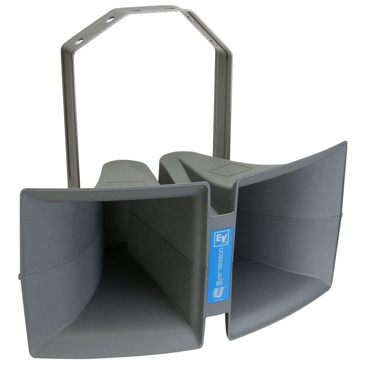

what type speaker horn is it ?
is it this

Sure looks like it.
mhardy6647
Dec 12, 2019
9,925
21,242
Yes the photo in the screen capture shows a CobraFlex horn.
These were have been* in production for a long time, under several different brand names.
They have been used in both domestic hifi and commercial sound reinforcement now and again. I'll offer no further comment ;)

I was able to trace the Cobraflex back to 1953 courtesy of https://www.alliedcatalogs.com/flipbook/1953_allied_radio_catalog.html
By the late 1950s Within a few years, the Cobraflex was on the same page(s) as University's domestic hifi offerings. :)
It's a compact way to get good horn loading, as long as high fidelity isn't a priority.

okay , cobraflex
horns are they more less the same used on emergency vehicles as i have to cover my ears when those pass by on the road , ear shattering , ear bending , maybe why the same siren sound used in movies doesn't sound anywhere near
are these of any real use for hi-fi , do they have honky sound that can be addressed with Peq , i have no experience with them , what is the frequency response ?
@Andysu The FR will depend on both the horn and the driver, as well as how well matched the exit geometry of the latter is matched to the throat of the former.
Here's a pretty good, well-written, and extremely practical white paper on the subject from Electrovoice:
Typically*, though, the FR curve will look sort of like a "monadnock"**.
The shrillness of public safety horns is, one might say, designed in. The horn & driver are tuned ;) to maximize cacophony. That isn't quite true for PA applications (as opposed to sirens), but it can sure seem that way. As mentioned above, some fairly respectable high-sensitivity loudspeaker systems in the early hifi era used the Cobraflex horn for midrange or "treble".
I have been unable to find a frequency response, which should tell you something. I would not use them for hi-fi today, since much better horns are available. The folding of the Cobreflex is a great idea for making it more compact, but has consequences of internal standing waves. Could you EQ it half to death and get something worthwhile? Well...maybe.

I am really, TRULY NOT OBSESSED with this topic. Just academically curious about the venerable Cobraflex. ;):cool::facepalm:
The document above shows the FR (as the "fundamental" in a harmonic distortion plot) of a specific EV driver (University ID30C) on a Cobraflex III horn.
As the genie says in Disney's cartoon version of Aladdin:
It's not a pretty sight.
EDIT: It's actually not too bad from ca. 300 to 3000 Hz. ;) I suspect that those two notches are related to the folded horn configuration as @fpitas mentioned a few posts earlier.

Thanks! I suppose were one determined, you could EQ it.
