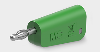

Personally, I'd rather get the ones from industrial suppliers such as Staubli (standard banana plugs are 4 mm). You should be able to get Staubli products from Farnell.
Great idea, thank you! I guess, with industrial ones at least we can be sure they aren’t totally crap inside. Will try to force my aesthetic side to agree as well.
Edit: pity, as it seems Staubli doesn’t make the plugs in the BFA variant …

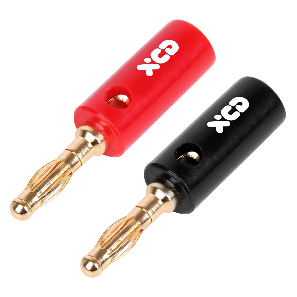

i use this type
simple single screw... bag of 10 is like $5 off ebay etc
ironically these work better with 12 awg given its *just* wide enough but there's more copper strands for the weak single screw to hold on to
i prefer slim as possible given some amps do not have enough real estate for big plugs, not naming any names but you know who they are (ie: everyone not doing 19" wide x 19" x 2ru components)
