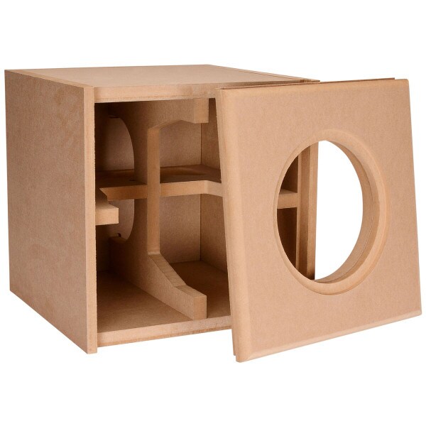

I am actually thinking now of building a box to hold some quality 8 inch driver, not necessarily a subwoofer driver but just some good woofer like the Dayton RS225-8. But I hate to have to build a box.

And that Dayton / Parts Express 0.75 cu. ft. knock-down box, yes I know about that. The Dayton RS225-8 wants a 0.5 cu ft box, but yeah it might be ok if somewhat underdamped.
