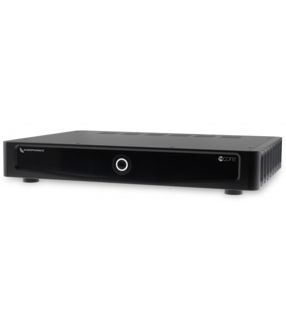

My only concern is the single PSU being a limitation in these stereo amps. I have an Audiophonics HPA-S600NCX here, but it will go back because it's not dual mono.

Btw, I'm with you regarding the Audiophonics amp. This larger case is really nice and robust, with heat sinks on both sides, large holes on the top and at the bottom. It's really a pity that it has only a single PSU.
I remember there was a dual mono build from audiophnics, i dont see them. Maybe you can send a email to audiophonic to see if they can make a mono purifi with the nice case and separate box for mono.. i don't know! just ask them.
Edit: i don't recommend to put these dual psu in that case... i mean is not very standard.. is better separate box and mono if you want absurd amount of power with no problems, i mean.. its a 1500w tank o_O ..

Yes, the idea is to have 2 completely separate mono block. That would pretty much guarantee that the speaker is not underpowered in any circumstances and even after a speaker upgrade (if I cannot make the KEFs sound right with this amp).
