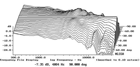

Here are measurements from the 9.1's back in the day. Everyone called them laid back but the measurements don't show them that laid back. So many used to that Klipsch sound maybe?
Maybe they appeared to some as laidback due to the strongly increasing directivity at the upper end?
Many years ago I owned a pair of 10.1 and also don't remember them to sound aggressive/forward.
Yeah, could be. I have a pair of 10.1's in the office and I never found them harsh. I bought quite a few Diamonds. Way back when I auditioned several speakers including some BW's (don't remember model) and the 9.2's stood out to me especially at the price.
