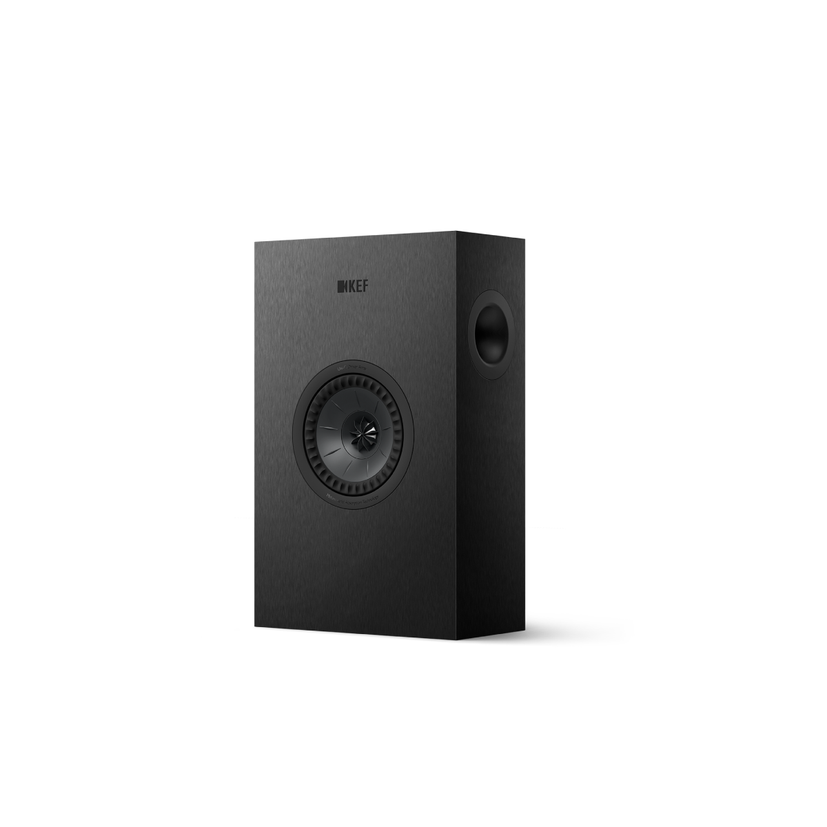

Have you also considered on-wall speakers?
I'm thinking that the Kef Q4 Metas might end up being comparable in price after you have factored in bashing holes in the walls, plastering and painting.

Like kyuu referenced, I am in the PNW and have easily modified drywall walls. So the labor is free :) So that still puts the Kef Q4 out of my price range.
I have 10' walls on that side which offers plenty of volume. So, I am pretty set on in-walls at my price, sound quality, and SO restrictions :)
