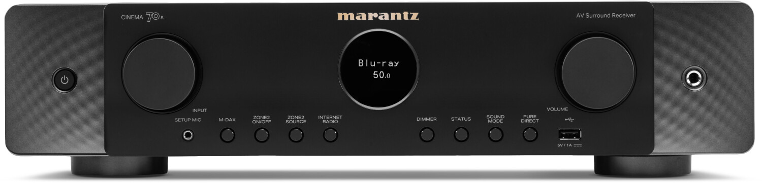

I currently run a Sonos Arc + One on my TV, but like to replace it with something which does a better job at stereo music listening. The Sonos Arc is rather unsatisfying when it comes to music. I am not new into Hifi, but I would need your help to find a proper AVR, which can take the TV signal via eARC and Spotify / Tidal connect for music listening.
I was looking into the Marantz Cinema 70s, because I can get it here for around 500 Euro new, and use the pre-outs with a used stereo amp to drive both front speakers. I was looking into something in the size of Elac Vela BS, or Kef LS 50s, whatever I find on the used market.
I read the review from @amirm about the cinema 70s, which seemed to be not so great. I also wish that the 70s would support dirac. So maybe there are better alternatives to consider? Especially if I spend 500 for the AVR + another 500 for a used Amp. Maybe there is a better alternative to start up on.
Would like to know what you think. :)

Your plan seems to be good, to use the C70s as a preamp/DAC . If yo look at Amirs test, the preout/DAC meassurements for the C70s are pretty good. I use a simmilar setup, but with a NR1606 and a NAD C272 (front). The NAD plays very good, and with 150W there are plenty of power. Highly recomended. Be careful though, before you buy. The C272 is more than 20 years old. To use the C70s as a preamp/processor is a good and cheap choice. Good luck.
I`ve now replaced the NR1606 with the C70. Works great, specially the video upscaling is a big difference to what the 1606 could do. The only hack is the C70 DAC in stereo. It`s not bad, but I tried the Topping D50 III ($300) between my Roon server (USB) and the C70 (RCA out) with Pure Direct and it sounds great. This little DAC from Topping is great value for your bucks.
