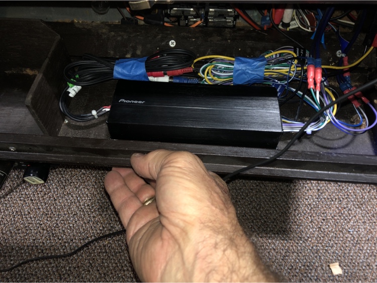

What I installed: Pioneer GM-D1004 amp. Amir tested this and thought it pretty good for the money. I’m using it bridged into two Dahlquist ALS-3 mini speakers. The speakers themselves are interesting, being tiny three-way speakers with quite a complex crossover.

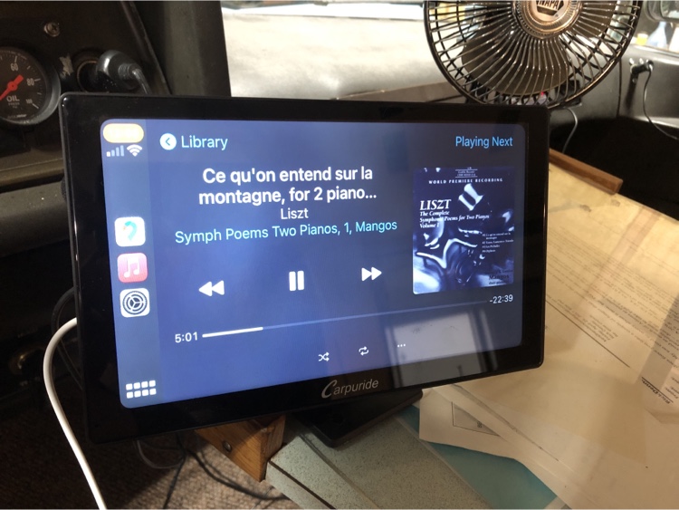

I also installed a Carpuride CarPlay touchscreen. That has been a good purchase so far. I mounted it on my center table. I made use of its support for a backup camera, but I primarily use it to play music, podcasts, and audio books, in addition to showing the phone’s navigation and integrating texts and phone calls into the sound system.

Here’s the amp. It’s mounted on the back of the fuse panel access cover, under the glove box.

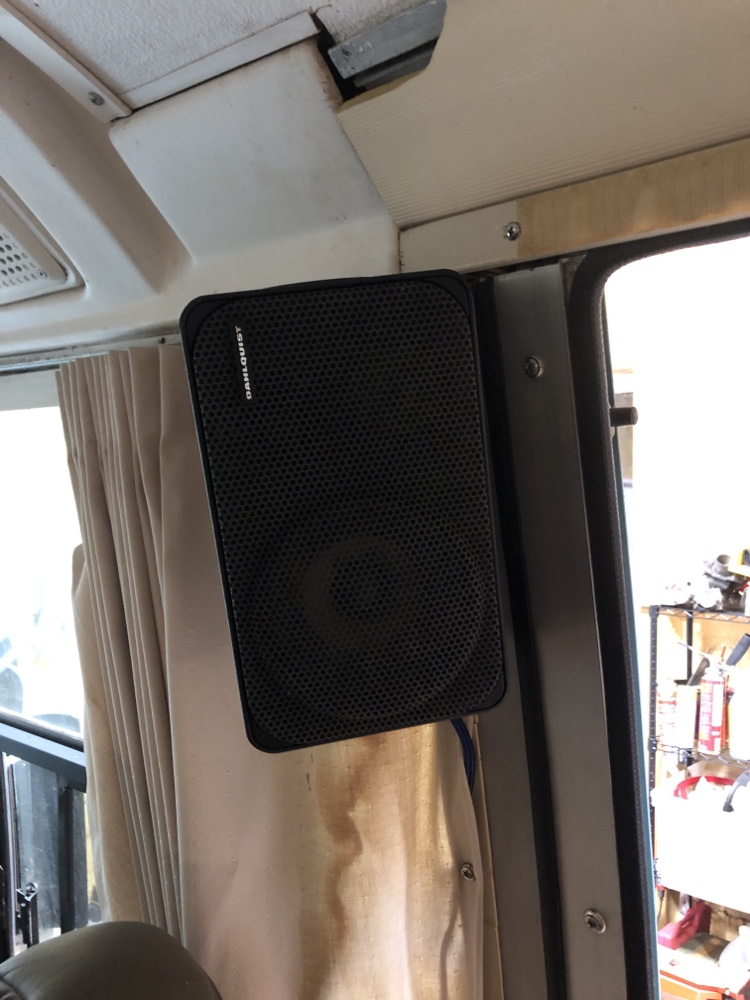

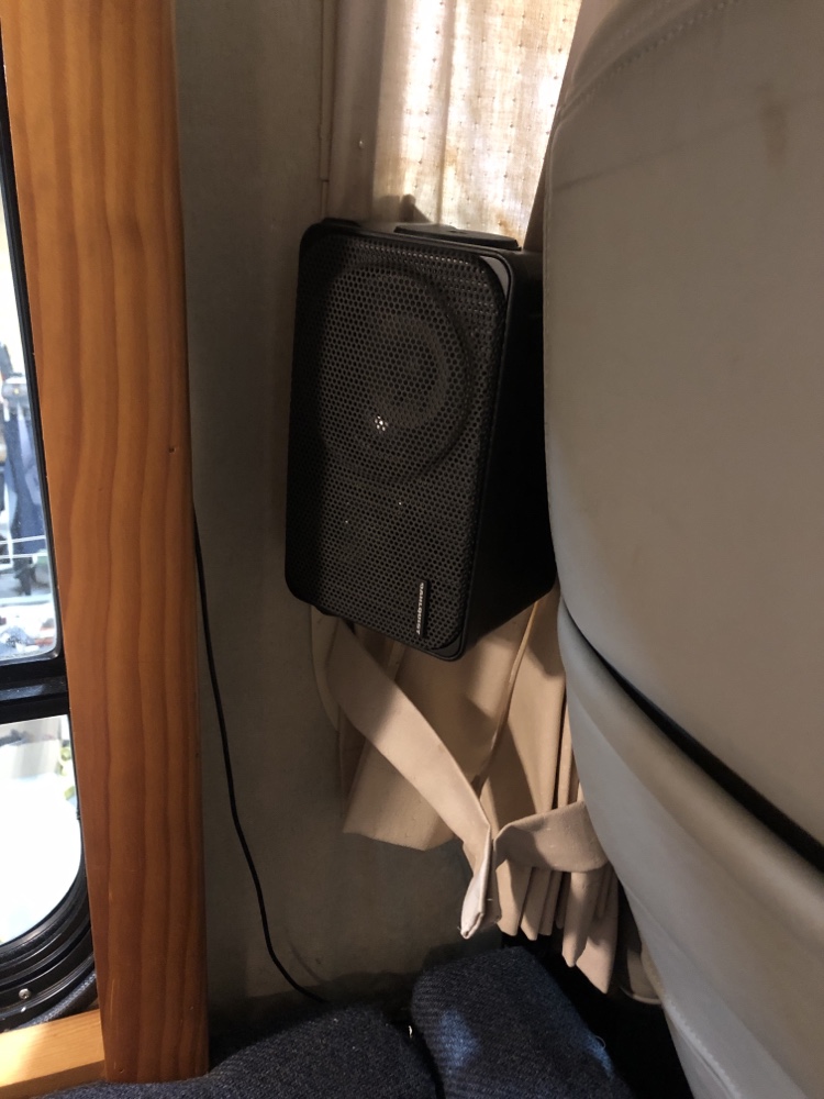

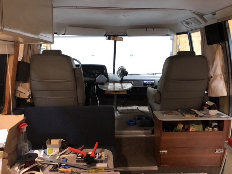

Pardon the mid-project mess, but here’s the “lounge” looking forward. The Dahlquist speakers are mounted on the walls. No, they aren’t the same height. Compromises are necessary in this use case. They are small but heavy and I wanted them to stay put, so I mounted then where I could sink screws into one of the vertical aluminum struts that serve as wall studs. But I had to avoid the overhead cabinet on the left.
And closeups of the speakers:

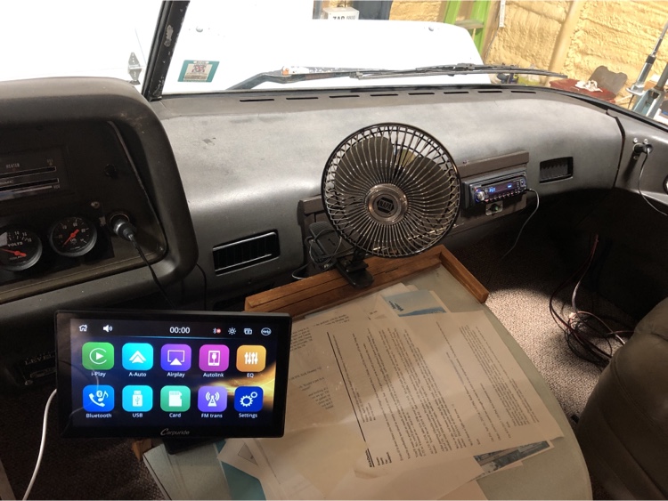

Here’s the cockpit. You can see why I needed something. The head unit is handy for the passenger but unreachable when traveling alone.
Here’s the Carpuride unit from the driver’s perspective.

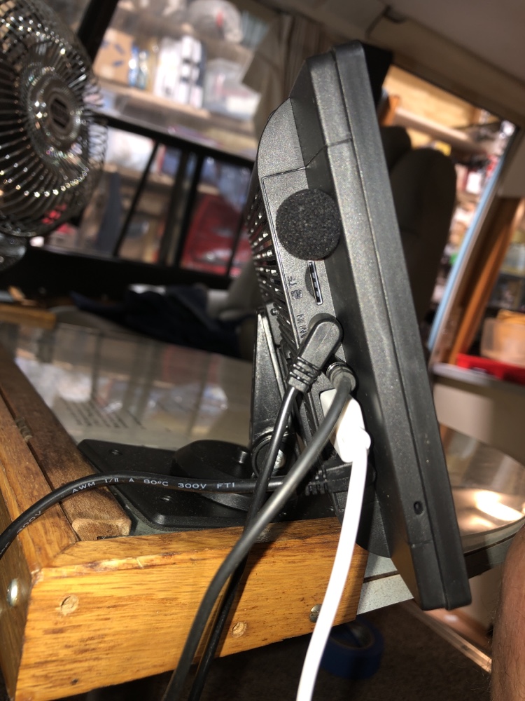

And its connections:
The Mangos performance of the Liszt Symphonic Poems transcribed for two pianos is a standard test for me.

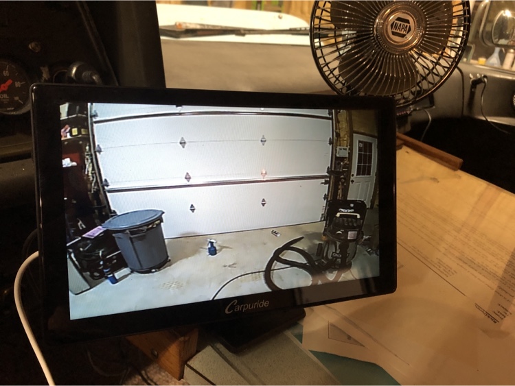

For those who are interested, the backup camera is awesome. I mounted it on a stalk over the rear-mounted spare tire. Running the wire from the camera to Carpuride unit was by far the most difficult part of the project. The GMC motorhome is quite compact, which means there is no wasted space through which one can run wires. I needed 45 feet of composite video cable to make the trip from end to end of a 23-foot motorhome. The camera is powered using the backup light circuit tapped at the nearby tail light. The Carpuride senses incoming video and switches to it automatically. Video quality is good enough. Rear video is transformative in a motorhome.

Good to see this progress. When you say "bridged" (& I presume that this is a 2 channel amp) does that mean that the DQ's are both getting one mono signal?
Also for the Carpuride does that have a feature that you can connect a "CD" player to it? If it has carplay this is a way to do that:

The Kenwood head unit has a CD player, not that I can reach it. But all my CDs that I play are on my phone anyway.
The Pioneer amp is a 4-channel amp, intended to drive front and rear stereo pairs in a car. But the four channels can be bridged into a stereo pair, rated at 90 watts into four-ohm speakers.
This Carpuride unit doesn’t appear to have a wired auxiliary input. But it does have Bluetooth. But it wasn’t a requirement for me.

I forgot (damn oldtimers disease) that that Model Pioneer is a four channel one.
