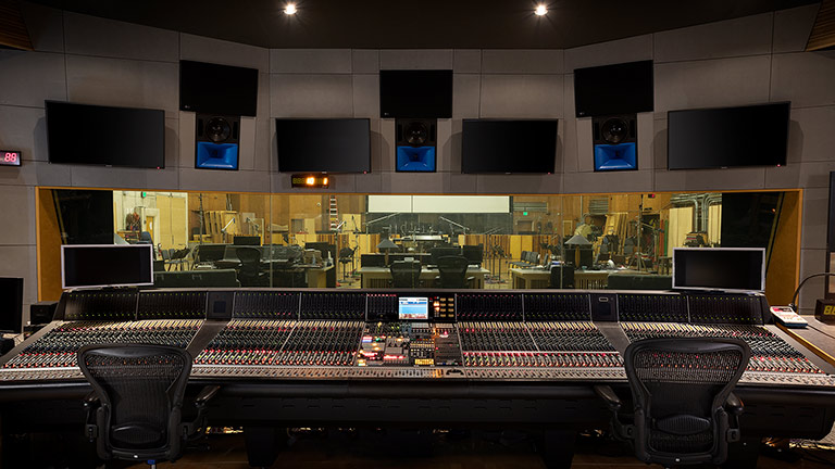

The obvious choice is Meyer Sound Bluehorn. It will come with professional calibration.
Why? It’s what studios actually use. Director’s Guild of America swapped out their JBL Professional for Meyer Sound.
Can run Trinnov + Meyer Sound, since that’s what studios actually use…
