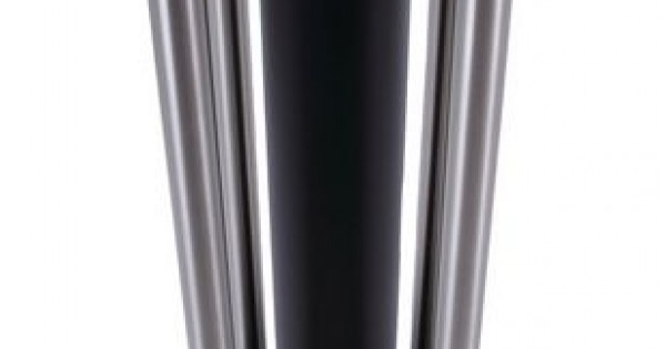

Correct loudspeaker stands are really important if you want your loudspeakers to perform the best. A couple of reasons exist:
1. Loudspeakers tweeter at ear-level.
2. No resonanses or reflexes from a shelve or desk. This is important .
3. Correct damping of the loudspeaker , which moves resonanses where the sound gets better.
Not all loudspeaker stand manufacturer care about this, but brands like custom design an Linn products sure do.
4. The ability to move the loudspeaker at the right position in the room. i.e correct distance to the frontwall.
It may seem unnecessary to spend money on this, but a good loudspeaker stand can better the sound.
Heres some reviews:
Was using a high-mass pair of stands from another UK manufacturer with my LS50 Wireless stands, but they mostly sucked the life out of CD-resolution music streamed from Tidal, with a heavy muddy bass & limited stereo imaging, so when Custom Design introduced this specific LS50W stand a few months back, I felt compelled to try a pair. Following straightforward assembly, it became clear that two bags of Custom Design's own filler per main column was the optimal amount & music immediately seemed more "alive", with much better dynamics, a tighter quicker bass & more focused stereo image than I'd previously achieved. Aesthetically these stands suit the LS50 Wireless nicely, a perfect match colour-wise & lovely satin finish - they really make them look & sound like a top-end pair of speakers! And a friendly helpful company to deal with too, would definitely recommend.”
The above statement sounds like clever commercial, but I can asure everyone that my Genelec 8340 sounds better on my Custom design rs 303, compared to my other stands. ( Im not a dealer :) )
