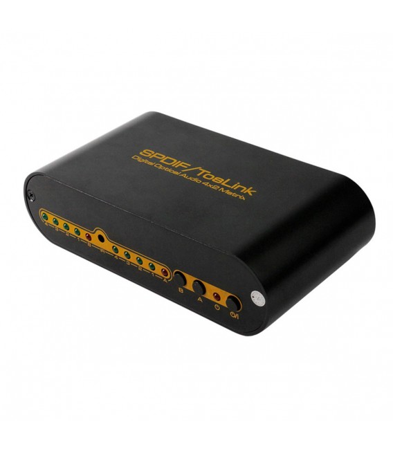

You can connect it to an analog input, but that is not ideal. You will need an device with more digital input (be it coax or optical) to connect all at once. A spittler won't work, a digital switchbox can work, but also costs money. Something like this could do the job (but i don't know the quality of the device).

The switcher would be annoying as it wouldn't be automatic, you would still have to switch opticals with a button or remote control that blows.
This one is automatic. I bought one and use it to switch between an optical from the TV and coax from a RPi Roon endpoint feeding into the coax input of the Ultralite Mk5. Works a treat. You can fine tune some of the settings from a PC connected to the USB port with the downloadable utility and driver.
Very favourably reviewed by Matthias Carstens of RME:
what if both are turned on, what happens then?
How would this work? Basically I connect from this device output to my audio interface optical input?
Is it better to choose the non DAC or DAC option with this? Since I would be bypassing the DAC, maybe is better NO dac to avoid potential issues?
So I connect this device output to interface optical input, then I connect my devices to this device's inputs
I just read this
"Optical/SPDIF Audio Switch with automatic input detection (it will automatically switch to the input where a signal is coming - if there is a signal on 2 or more inputs the inputs are prioritized - it will always prefer input 1 before input 2 and so on)"
The inputs are also prioritised.
Yes.
I'd went with the non-DAC option. The Motu has very capable DACs built-in. There would be no issues with the DAC option, but why pay for something you don't need.
Yes.
