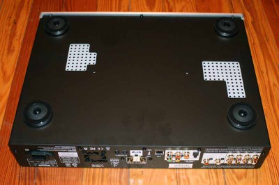

There was someone who did this about 10 years, but in a much worse way. They had put someone else's CD player inside their own case - literally a case within a case! I can't remember which brand it was, but it was something expensive, and they were caught out and shamed. I wish I could find the picture.
Ah, found it!
image_preview2
It's a Blu-ray, actually. This is a Lexicon BD-30 with an Oppo BDP-83 inside. You can see from this picture of the bottom that they just re-cased it and cut ventilation holes.
The source of this is Audioholics from January, 2010:
There are more pictures in the article. The author noticed that the Lexicon's external layout looked very similar to the Oppo. First he opened the case, then he realized it was in fact the Oppo player just inside a new case!
Oppo retail price at the time: $499
Lexicon retail price at the time: $3,500
@Azathoth, you underestimated how rich you could get.

Ah, found it!
image_preview2
But the R&D for the custom case-over-case had to be massive.
This from another “audiophile” brand, same deal just a couple years earlier
Great; didn't knew about the Theta. I do wonder though how companies expect that they will not be caught cheating, and that it's almost guaranteed to destroy its reputation.
