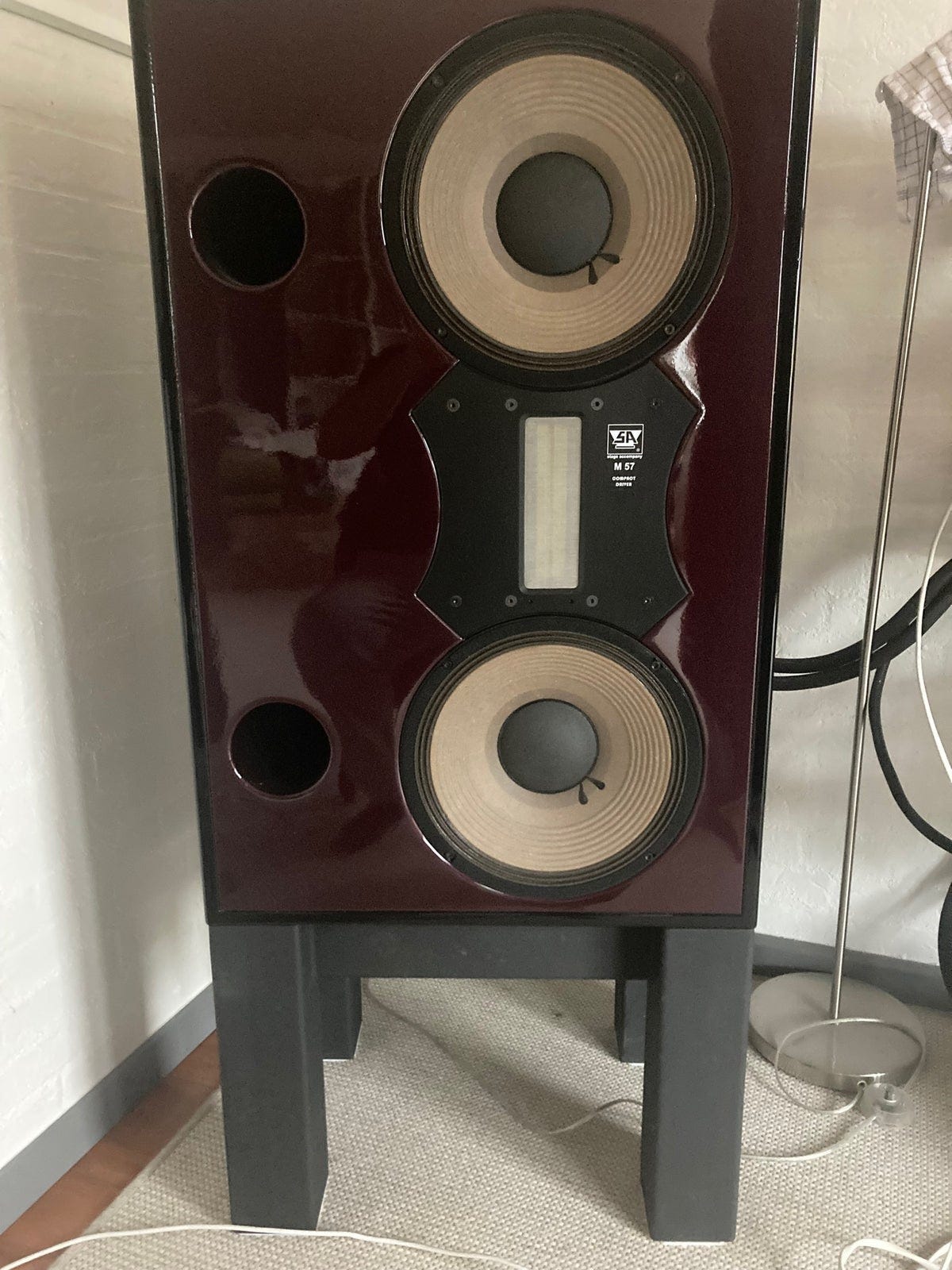

A pair of StageAccompany M57 monitors.
”M-57 Studio Standard Stereo
Active or passive crossover, DSP Correction via HE-50.
Made of 18+18mm plywood/MDF.
Surface in studio standard black semi-matte protex surface.
H x W x D: 91 x 61 x 40 cm. Weight 84 Kg/each.
Kr. 48.000 Dkr”
48’ danish kr = 5300 £
You can find them second hand some times. Use Hifishark.com to find a pair.
I listen to simular music like you do.
Owned a bunch of small and large well regarded speakers and the StageAccompany M44 (smaller sibling to the M57, now obsolete) is the one that allways stays. The are just so complete , powerfull and effortlessat ALL spl leves in an home environment.
Very easy to drive, you would probably do very well with a Wiim amp pro.
I use a yamaha ax-590. Tried many poweramps and big integrated amps. Can’t tell a different. Even a Denon DM-38 (2x18w rated micro cd receiver) did quite well.
Edit: price is for each speaker. Missed that bit.
But if you buy secondhand you should be able to find a pair with in your budget.
