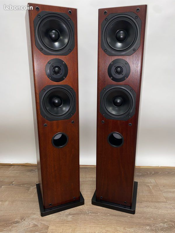

And the Elipson Morgane 2: chech this picture
The amp and the speakers are more than 20 years old. I was young at the time, and obviously more of an audiophile than a hifist. I listened to so-called "experts" and bought some snake oil in the process (cables, power strips and stuff). I think I'm a bit wiser now. :facepalm: With that said, my current setup still sounds pretty great. It's an "ear pleaser" that amazes my friends on a regular basis. But when the tubes have to be replaced, it's a bit of a chore: the new tubes have to be matched (the amp has a fixed bias), I need to go to a local Hi-Fi store, and the whole process is pretty expensive.

  • The speakers, not so much: about 200 €. :facepalm:

I would look into Parametric EQ, and a DIY upgrade of the speakers - if they need it.
Filling replaced with pure wool, thickening it up behind the drivers, maybe felt strips tied onto the basket frame spokes.
Crossover: electro capacitors with fresh poly ones. If it's a cheap (low order) crossover, consider bi-wire posts and an external crossover or bi-amping with an adjustable line level crossover, behringer etc.

One last thing: I could also keep my Elipson Morgane 2. They're 20+ y.o, but they still sound good. I'd like to change them, but if I do so, I expect a little step-up sound-wise. Otherwise why bother, right? As for the amp, I love my Jadis (the "tube sound" with all those even-rank harmonics is great, makes you forget about the measurements). It's just a little complicated maintenance-wise. Tubes need to be replaced periodically, they can stop working at any moment, etc. I'd love to have some peace of mind, instead of thinking "maybe today the tubes are going to blow up" every time I flip the ON/OFF switch! :facepalm:
