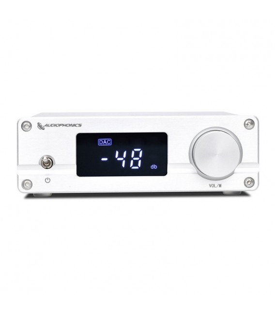

I'd just choose between Audiophonics and Nobsound based on what is needed more: XLR support or Bluetooth and postpone researching more expensive options to the future if it's even needed because both are dirt cheap and quite likely to do the job. The star of the show is going to be the new Hypex amp anyway and I suspect people at Audiophonics designed their preamp exactly for those new Hypex and Purifi power amps they sell.
New preamp of Audiphonics and maybe is same with Nobsound-NS-08P Pro
