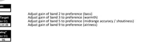

A further question is--there is a bit on these pages about EQ with these headphones. Pardon, but I don't know how to add EQ.
Best way to EQ on macOS is to install SoundSource.
You can then import oratory1990's EQ preset for the HD800S (attached below) like this.
Lastly, you can follow the instructions in the bottom right corner of oratory's PDF (where this preset comes from), to adjust the EQ to preference:
