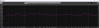

Ya I do have a Dayton USB mic and I should really do a measurement at 1 meter from the loudspeaker as well as listening position to see how it compares with the solid state. With my Solid state (Ramsa amp), this was the response of the speaker at 1 meter. Its not ruler flat but I think not too bad for DIY and being open baffle. Maybe this weekend I'll do it again with the tube amp. Good idea. View attachment 316491

Apologies for the delay. I did actually. There was some variance in the bass - a little more lean for the tube but subjectively while listening, it doesnt sound like its the 3db or so difference. The red is the tube and the blue a solid state (Behringer EP4000 - QSC RMX clone). Also the output voltage at the time of measuring was 0.2v lower so might explain why its just a tiny bit lower across much of the range.
IMO That is most likely caused by the higher output impedance of your tube amp compared with the solid state amp - especially where you see the increased deviation in the bass area. If there is a speaker impedance dip in a frequency region then the amp output will also dip due to the increased current through the amp output impedance.
The variation at the top end could well be a slight rolloff in FR at the higher frequencies of the tube amp.
Ah that does make sense now that you say it and I think about it. My open baffles are lower in impedance in the bass area so I guess current requirement would be highest there. Subjectively though it still sounds great in the bass. Maybe very slightly more light like one tick on a tone control lets say.
Or easily fixed with a little EQ.
