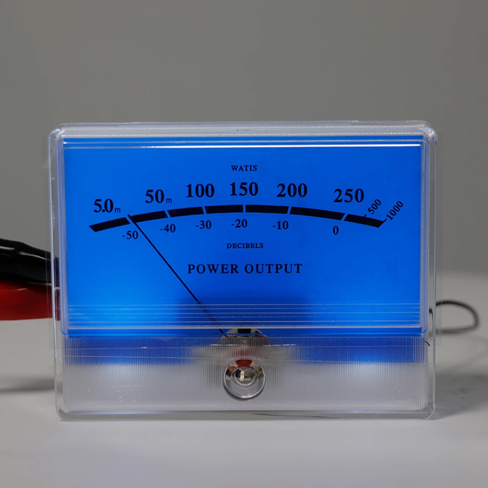

8.2US $ 50% OFF|Tn90 Pointer Vu Meter High-precision Digital Power Meter Head Level Indicator Audio Spectrum For Speaker Amplifier - Current Meters - AliExpress
Smarter Shopping, Better Living! Aliexpress.comwww.aliexpress.com
Those above are a direct replacement but are a bit thicker due to the led panel backlight. So some slight tinkering is needed with the existing standoffs. Also, before you remove the old meters, be sure to turn the brightness potentiometers on the board to the lowest level to get in range of what the new LEDs need.

It looks like the dB indication is not matching power indication?
every 10 dB is a factor 10 in power.
then it should be:
0dB 250w
-10dB 25w
-20dB 2.5w
-30dB 0.25w
-40dB 25mw
-50dB 2.5mw
What was I thinking!!??You mean these numbers are supposed to actually mean something ?![]()
It does look really cool and looks like a fun project.You mean these numbers are supposed to actually mean something ?. I just like the blue color and watching the needles move to music, which I'm guessing is the majority use case AND it's cheaper than a McClock ($1800)
