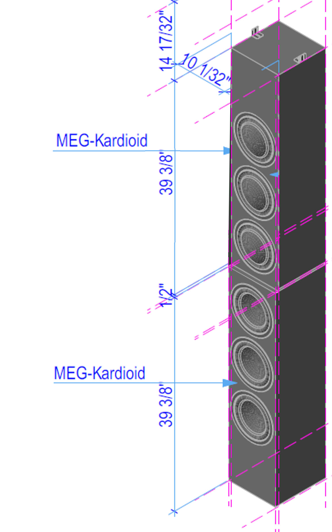

Here is the concept I have come up with for future systems. Because it is cardioid 2Pi, the woofers will have to work one third less than sealed or ported speakers on active room correction duty clearing reserves for much needed headroom, the speakers are adjustable and boundary decoupled (ideal for spatial imaging toeing in ), the towers spread 6 x8" inch woofers vertically covering 2 meters of vertical wall space (think multi modal active room correction).

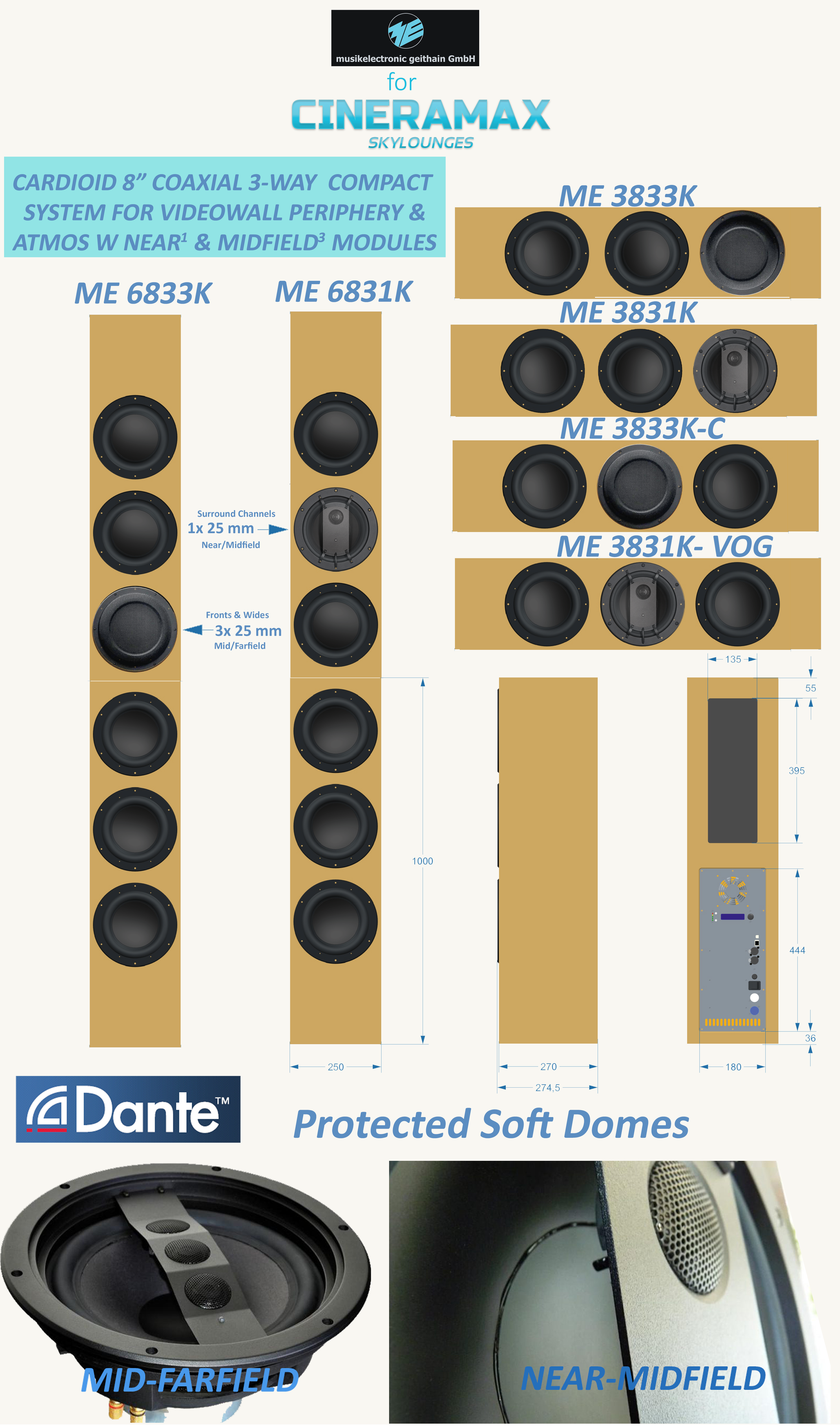

The modules are based on these two speakers, the ME 804K, there is a 50%chance I can get these to Amir to measure, but check the Data here.

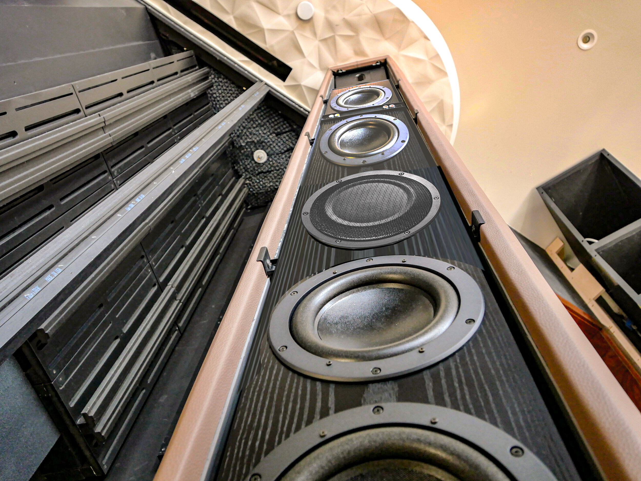

However the decorative double plywood wastes space so the modules are based on the BASIS 804K that was built for my leather wrapped steel columns.
the stack
Cardioid Backwave venthole
column
The near-midfield model has a single tweeter with a Directivity index that is preserved from the triple tweeter model, from 100 Hz ... 10 kHz increasing from 4 dB to 10 dB.

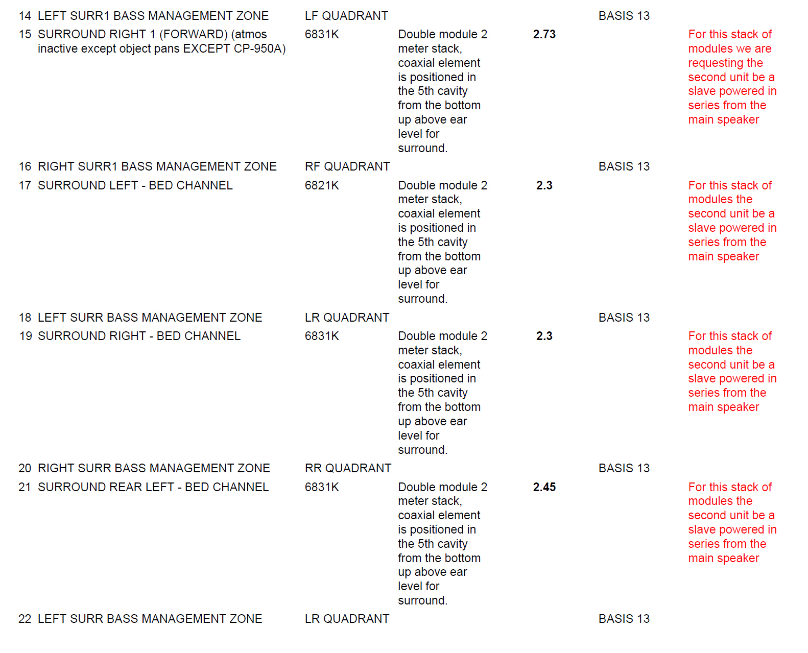

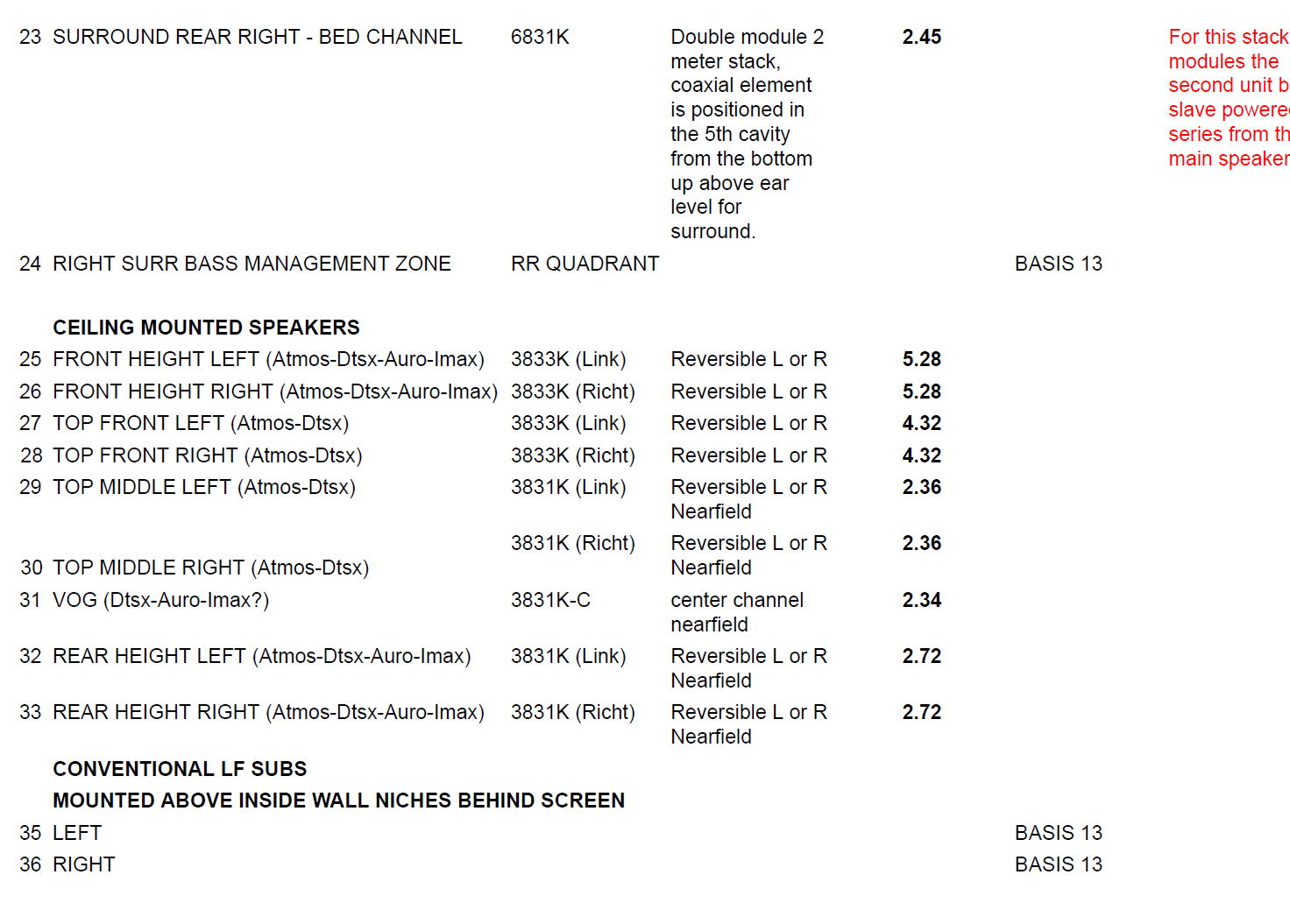

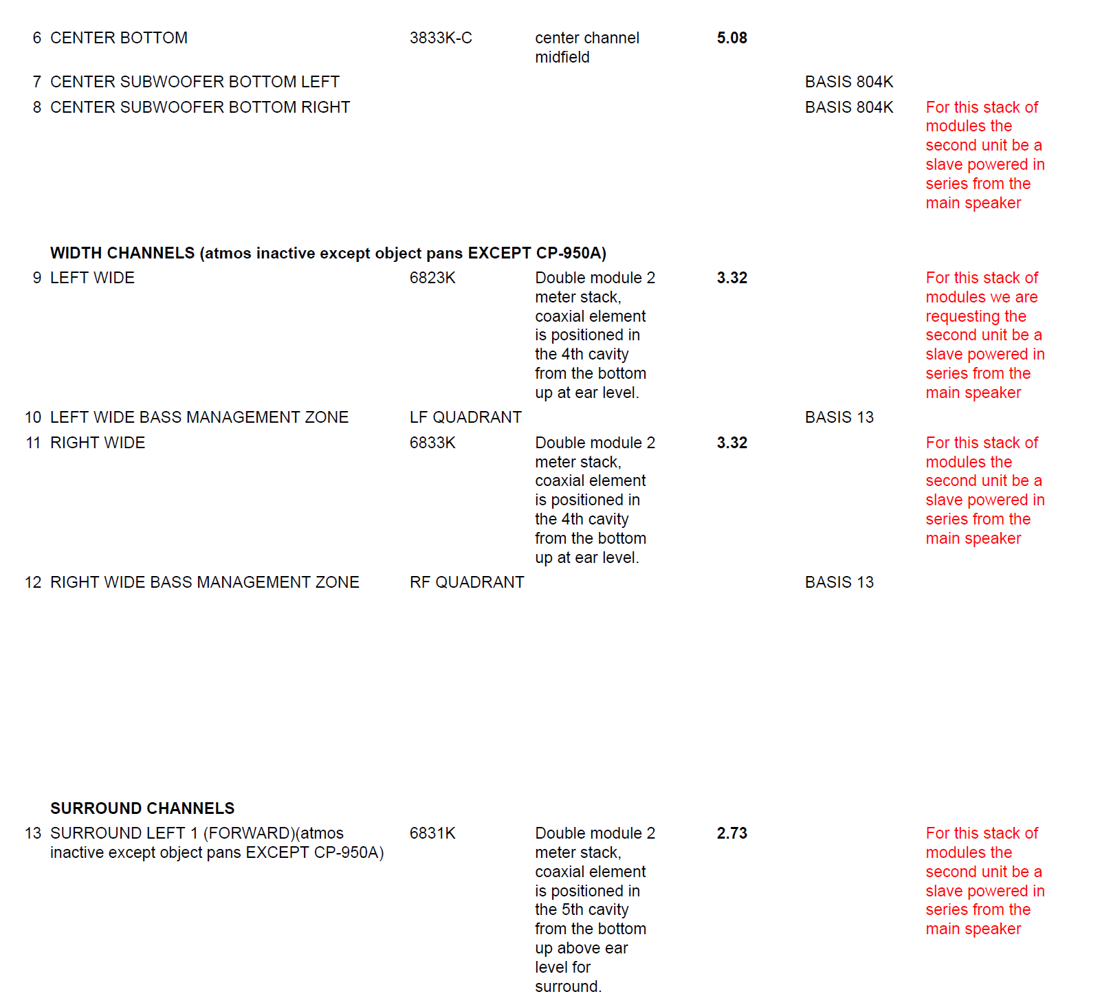

Here is a list of channels.
OK EXPERTS PLEASE CRITIQUE. ;)
