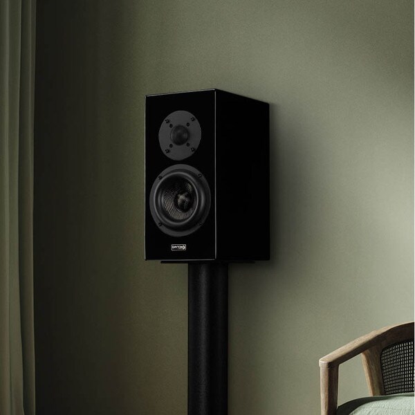

Not a kit but a finished speaker for $800/pair. See what you think…
No real measurements posted as yet. Is a passive radiator design using Dayton drivers.

It does annoy me when marketing uses picture in a placement that they recommend against.
It looks like it is about an inch out from the wall. The manual states 1-2 feet.
Which makes their placement on top of a shelf, that they show as being okay in the manual, pretty difficult too
