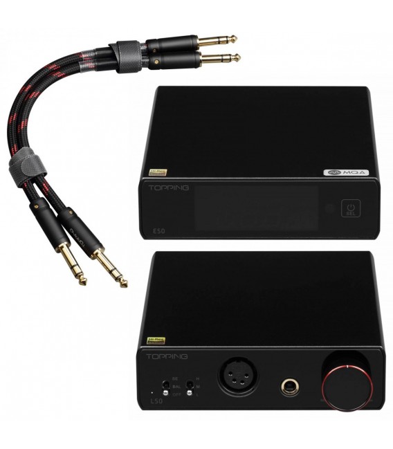

Is there some issue with your onboard audio that makes you want an external DAC and amp? Background hissing or too low power output?
jae
Dec 2, 2019
1,208
1,508
Why does it need to be a "stack"? Pointless having separate units for most people since there is very little point in "upgrading" part of it later if you buy a good unit to start. If you don't have a particular reason to have separate units, better to get a MOTU M2/M4 (which also has mic and line-in ADCs), or if you want more versatility with headphone power (for the prospect of using insensitive headphones later and having lots of headroom), get combo unit from Topping like the DX3 Pro+ or DX5/EX5 and be done with it. Only thing better is the topping DX7 Pro+, the Topping 90-series separates, or RME ADI-2 DAC series all of which are above your budget. Some of the other brands suggested in the thread are fine as well.
