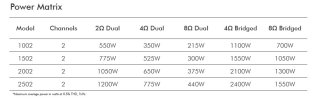

Crown XLS series:
It has built-in DSP which you can use, among other things, to filter out subbass for even cleaner playback.
Built like a tank for PA applications.
Naturally it won't be as silent/hiss-free as modern HiFi Amps.

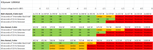

Since we now have real world torture test I would suggest to make an amp based on two icepower 1200as modules:
More than 600W/ch under any circumstances with music for more than microseconds as the usual power tests.
