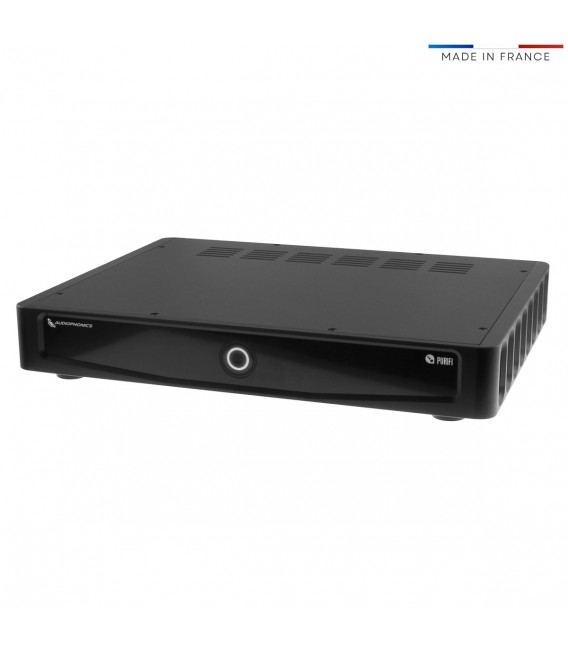

My question is, I read Amir's review about the X3800H and I understand that the pre-outs deliver around 1.4V. I am considering an upgrade for my frontstage through 1 Stereo and 1 monoblock (maybe start with just the stereo). The vendor that meets my travel pattern is Audiophonics. Based on many threads on ASR I get that there is basically no audible difference between these amplifiers Purifi,NcoreX,Nilai (at the same level/variables). Now since I am bound by the low preout voltage on the Denon. Would it be best to go with 1ET6525SA with around 25db gain to get full power AND better signal quality? Or NCX500 at 31db buffer?
I noticed in Amir's review of the Apollon implementation of NCX500 that using the buffer reduces SINAD slightly. Would this mean that I should always opt for amplifiers with lower buffers that match the preamp's output voltage (assuming both amps are of similar quality like these 2).
They offer HPA-S600NCX (NCx500 modules) which offer these gain settings: I figured I should be around 31db to get full power.

They also offer HPA-S450ET (1ET6525SA) which offer (in RCA):
12.5dB / 5.03Vrms
20dB / 2.12Vrms
25dB / 1.24Vrms
29dB / 0.75Vrms

I noticed discrepancies in NCX500’s gain settings on Audiophonics website:
Description
Total gain of 11.5dB - Maximum power reached with a 13.03V RMS signal.
Total gain of 19dB (default) - Maximum power reached with a 5.5V RMS signal.
Total gain of 24dB - Maximum power reached with a 3.09Vrms signal
Total gain of 28dB - Maximum power reached with a 1.95Vrms signal
In the table at the bottom of the page:
Gain (selectable) Bypass : 11.5dB 19dB 25dB 31dB 33dB
I emailed them (they are very responsive, it is impressive really).
Their response: The table at the bottom was outdated. 28dB is the maximum gain and requires 1.95vrms, they fixed it. Which is outside the Denon’s comfort zone (if i take into consideration the preout only mode and 2.0vrms, I would still be cutting it close in terms of getting the full output power of the amp)
I know I will never need 600w for my setup, but the perfectionist in me wants everything to work as it should
I am more inclined towards the 1ET6525SA now which costs around 200 euros extra. Anyone here tried it yet?
