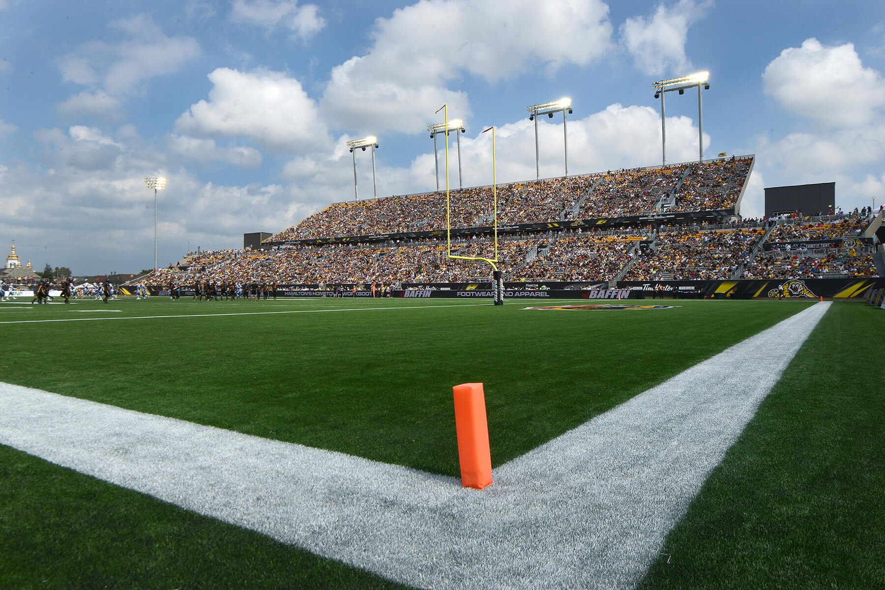

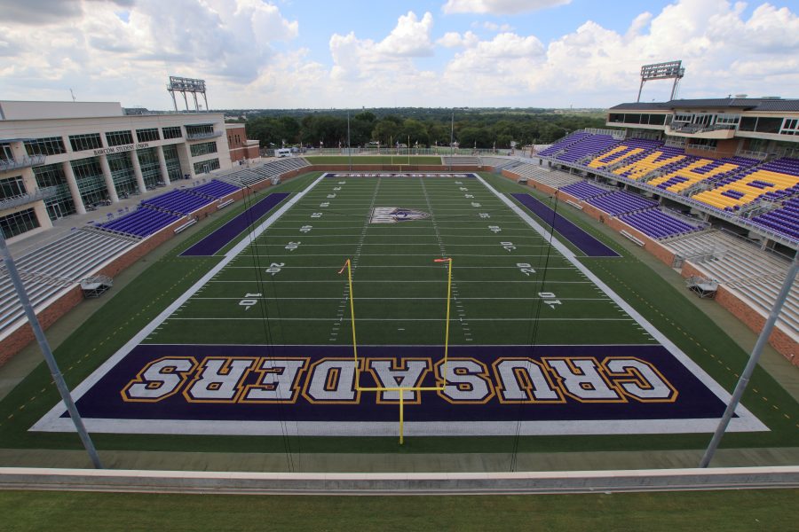

In America:
Posted this video in another thread some time ago:
A few more details of the system:
