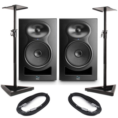

Find the space to place speakers on sides and tweeters in line with listening position (ears hight) and go with active but big one's and basic unbalanced DAC with Toslink optical input from TV.
It will cost you more of course.
Kali LP 8 V2's with stands (and cable you won't use) 428£:
You can use it for first time with TV line out trough headphone 3.5 mm out (in line out mode!) or if it has RCA line out. As that won't be optimal on the long run something like WiiM pro with remote about 125£ +19~20 for remote for the sake of PEQ's it has streamer only as a bonus. And of course rent borrow or buy measurement microphone to set the EQ, buy cheap deacent cables you will need if you don't have them already (unbalanced RCA and Toslink).
Thank you, but unfortunately I don't have the space to place the speakers on the stands outside the TV wall, as I already mentioned.
Well I tried, it won't sound good no matter what you buy if tweaters aren't in hight with ears, wave guide helps but just a little bit. If you go with smaller speakers then you need sub and at least 10" one which complicates things either way (speakers or half deacent soundbar regarding proper integrating of such) and you will need at least basic EQ capabilities and in PEQ form anyway. Soundbars won't really cut it (especially regarding highs).
