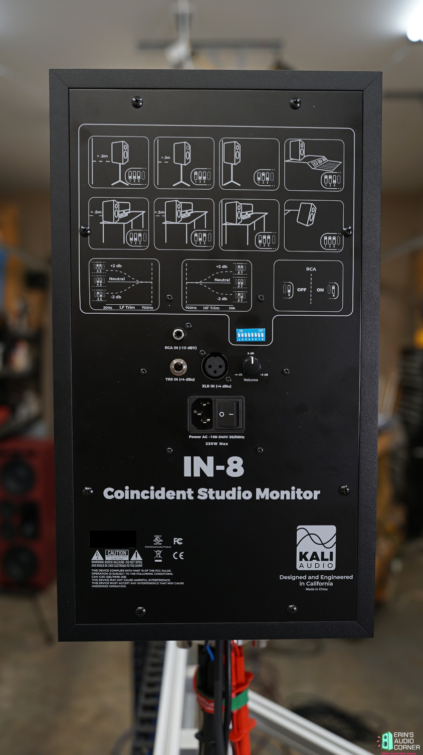

The back features a bank of dip switches for boundary settings and basic level adjustments. There is a volume knob and (3) input options: XLR, TRS and RCA phono.

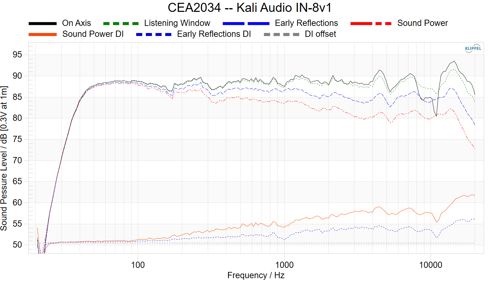

Measurements are provided in a format in accordance with the Standard Method of Measurement for In-Home Loudspeakers (ANSI/CTA-2034-A R-2020). For more information, please see thislink.
Note: The roll off rate of this speaker is sharp and therefore some noise was unavoidable at 25Hz which causes a spike in the response here. Ignore the response below 25Hz.
CTA-2034 / SPINORAMA:
Early Reflections Breakout:
Estimated In-Room Response:

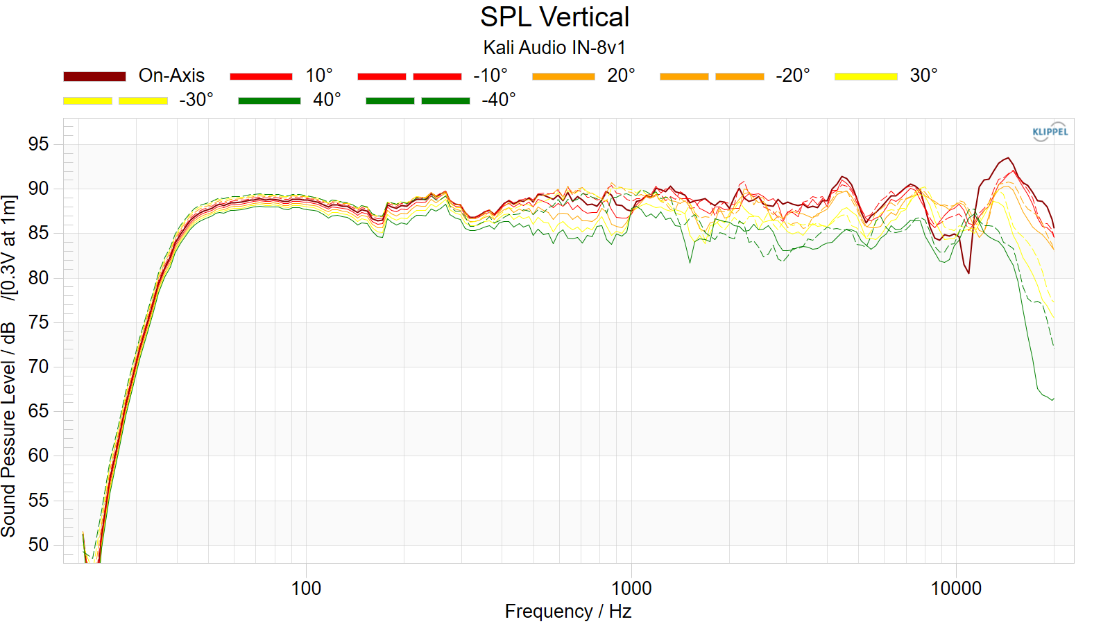

Vertical Polar (Globe) Plot:

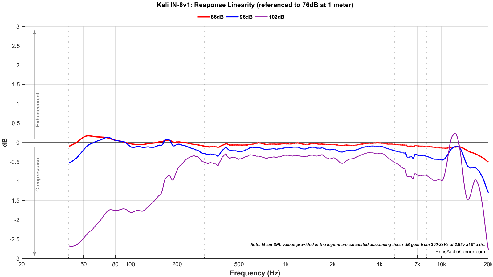

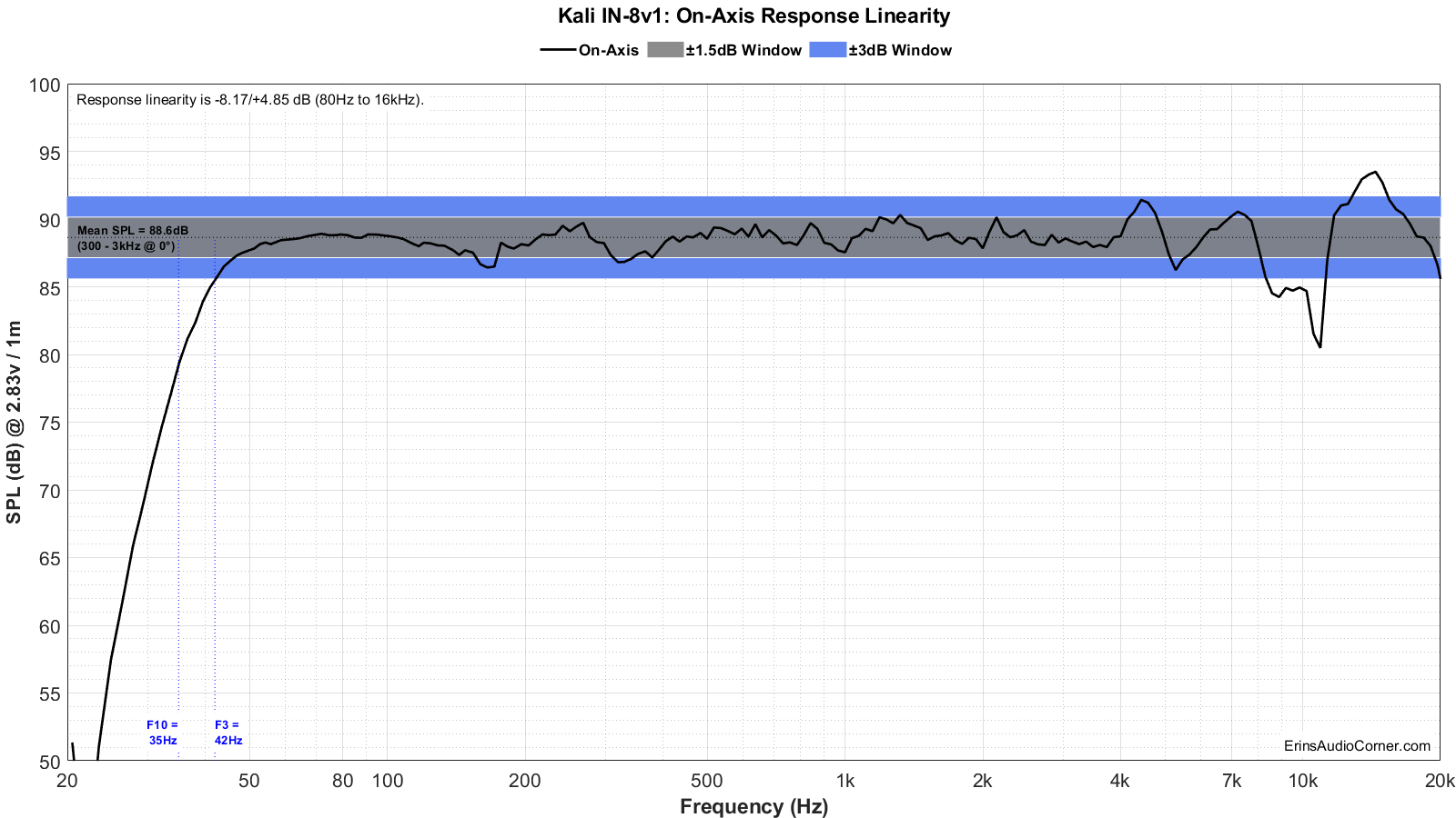

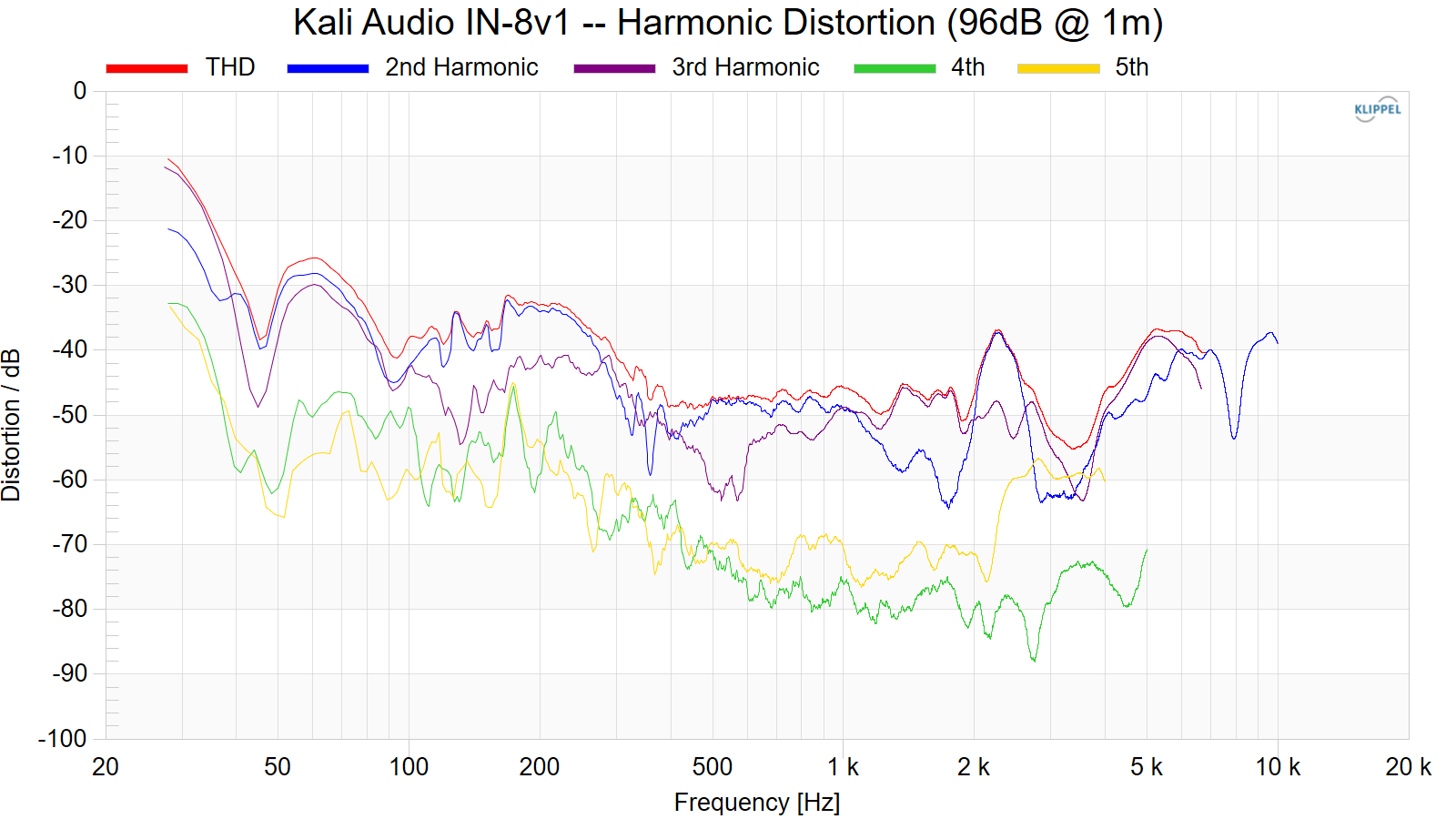

Based on my results above, it is obvious the output is limited (via internal DSP) somewhere above the 96dB @ 1m output level.

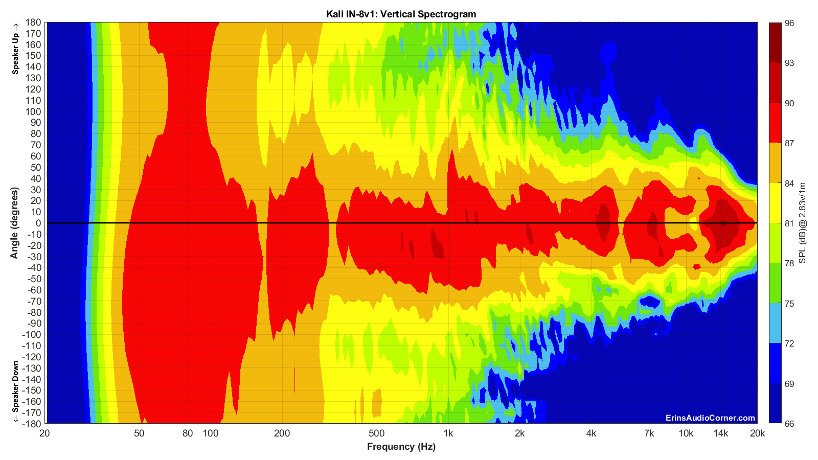

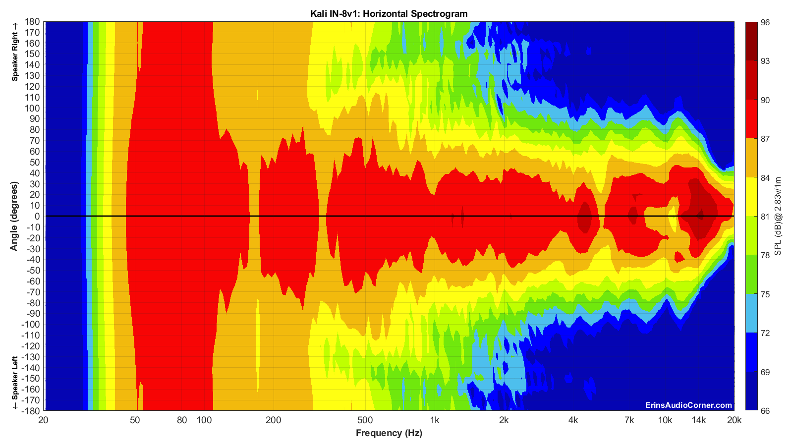

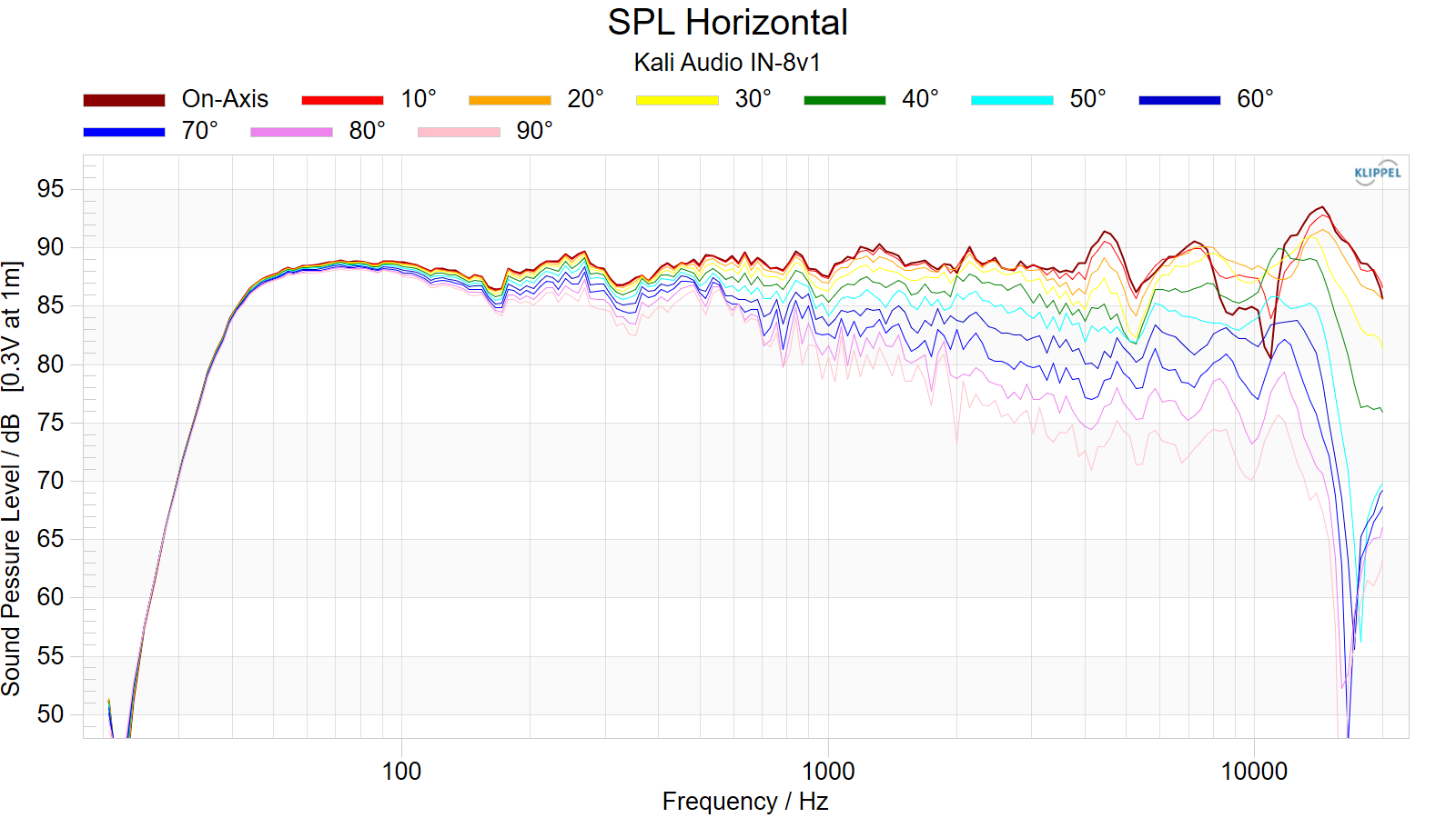

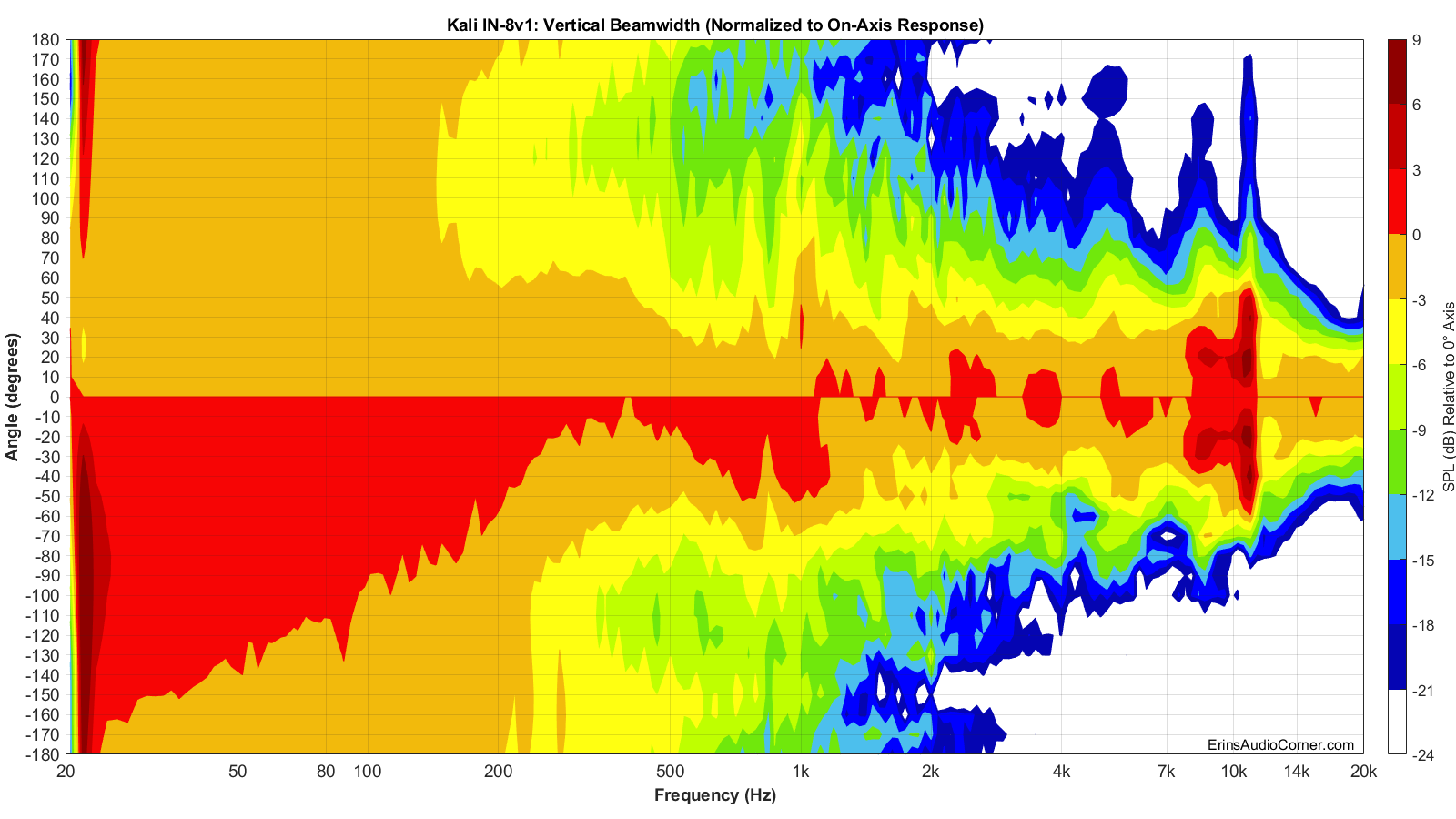

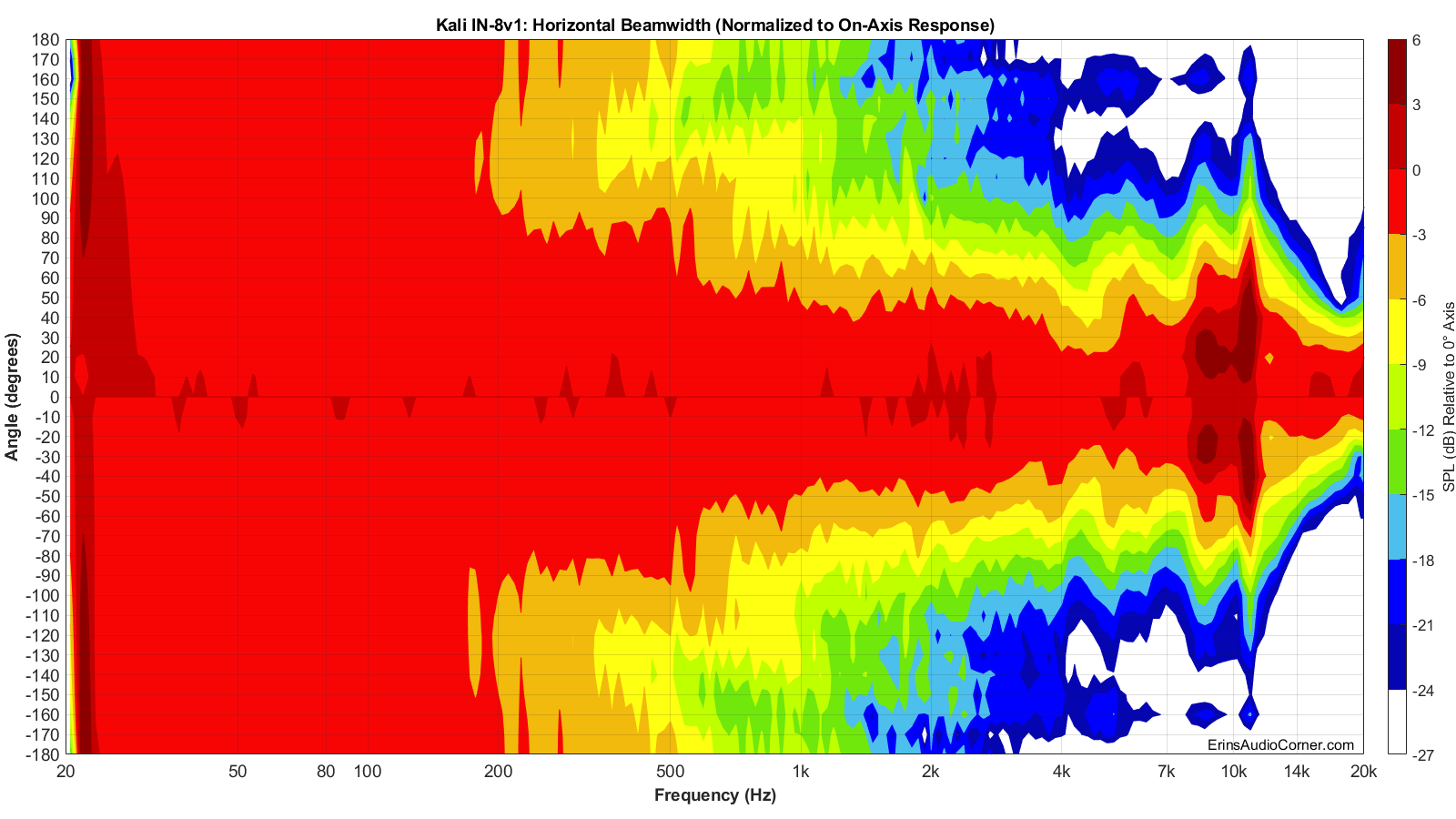

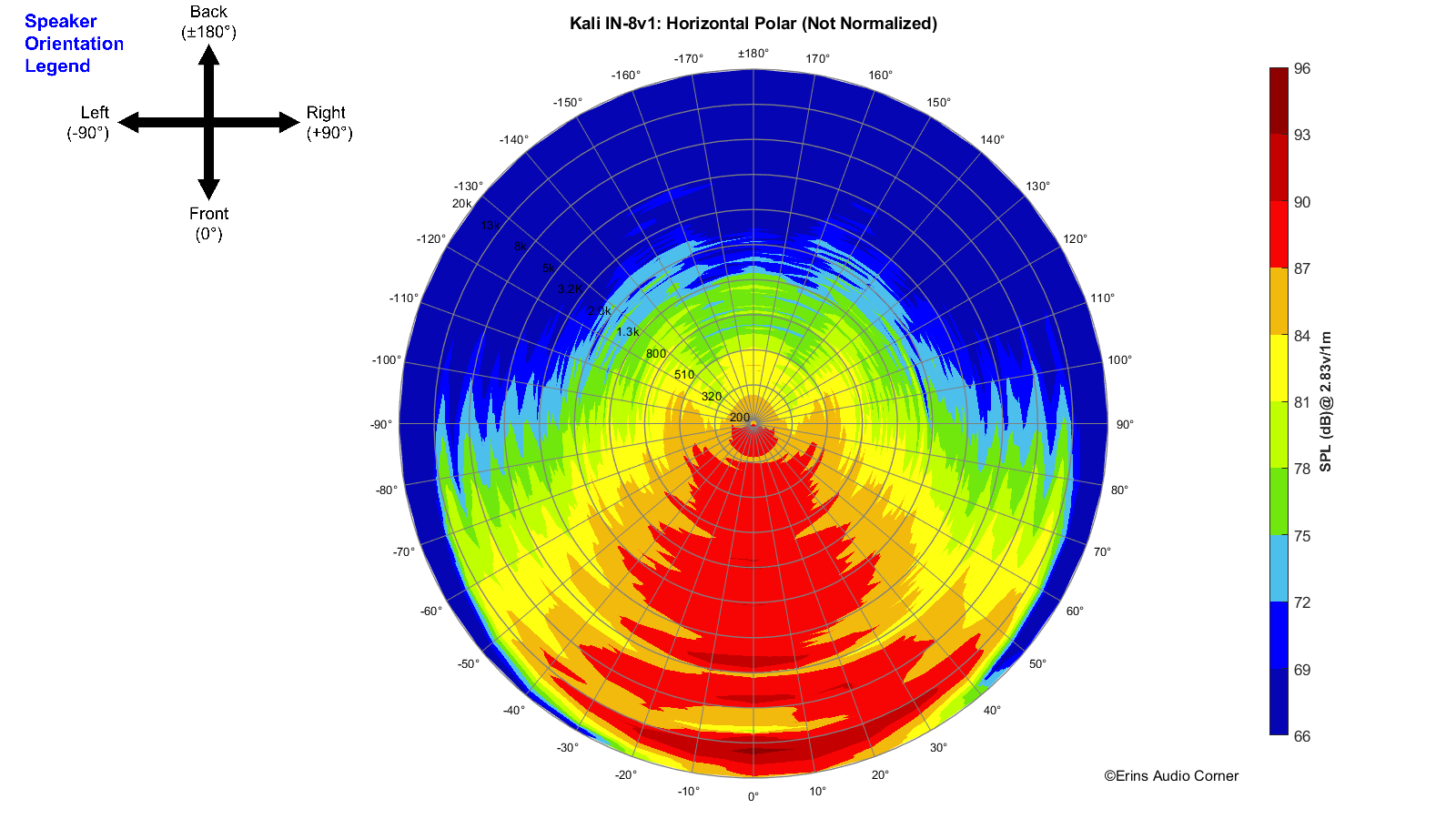

Overall, I like these speakers, especially for the price. The bass is quite nice, the midrange and highs are very mostly neutral. But they have room to improve. The high frequency combing and large dip on-axis centered around 10kHz concerns me but turning the speaker slightly off-axis remedies this. Plus, in a typical room setting, I can’t say that listening on-axis is even ideal with these speakers. I recommend toeing them by about 5-10° either inward or outward, depending on how much sidewall interaction or width you want. The directivity is quite good until above about 4kHz where the pattern changes and gets a bit wider in radiation before the on-axis dip at 10kHz.

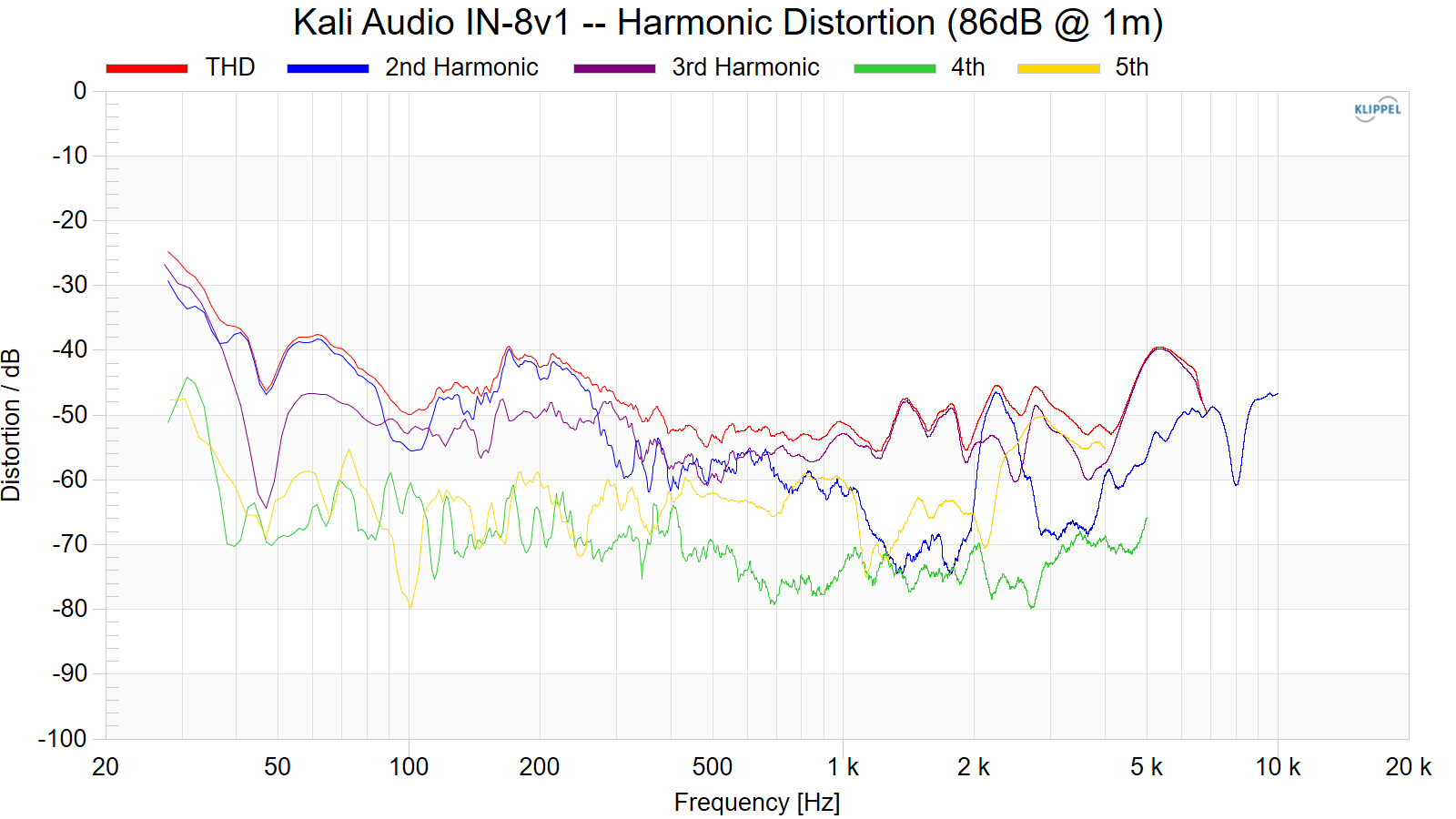

Harmonic Distortion
- 76dB at 1 meter (baseline; black)
- 86dB at 1 meter (red)
- 96dB at 1 meter (blue)
- 102dB at 1 meter (purple)

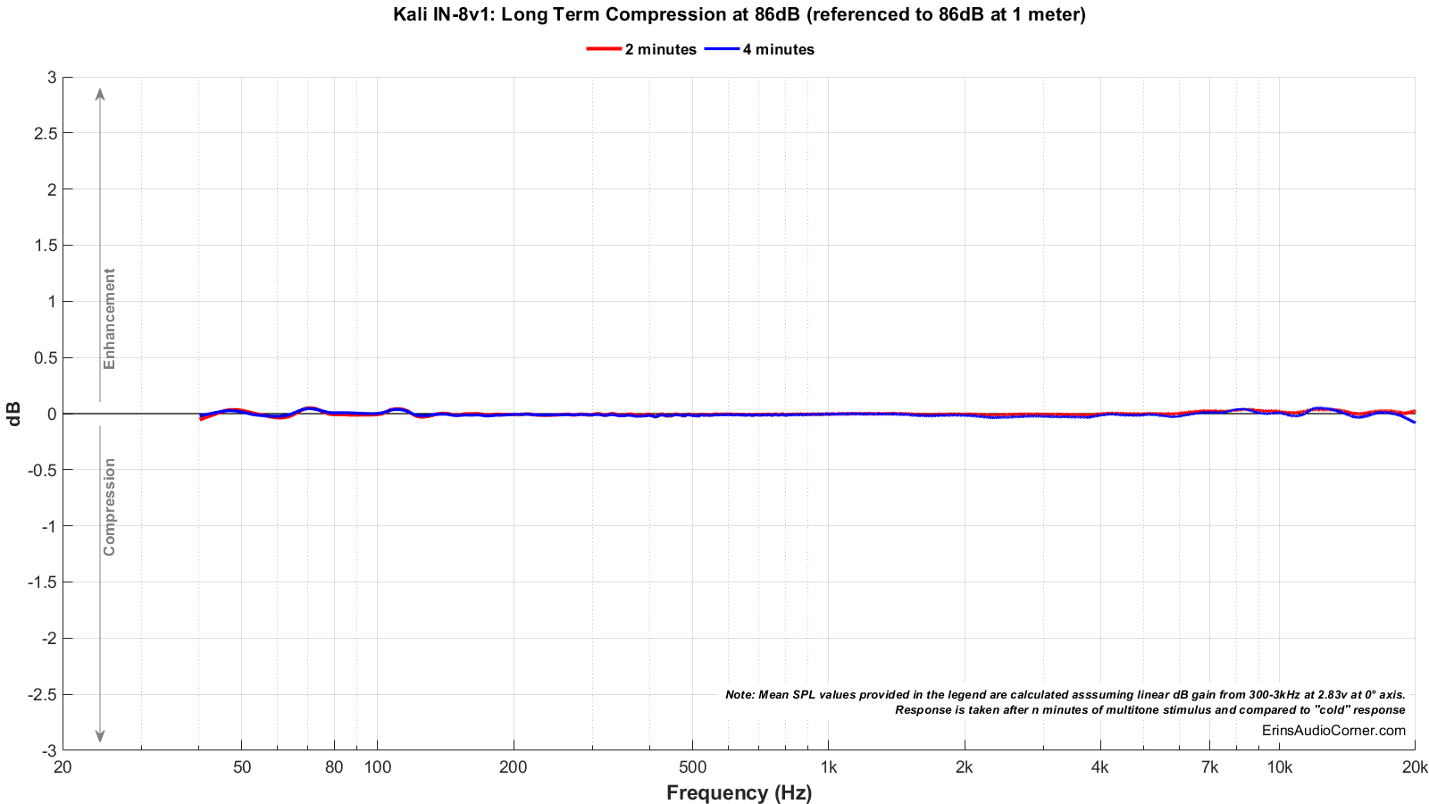

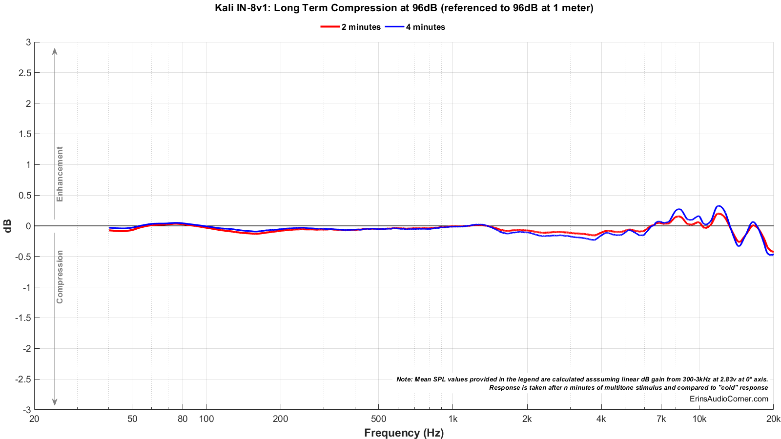

Long Term Compression Tests
- “Cold” logarithmic sine sweep (no stimulus applied beforehand)
- Multitone stimulus played at desired SPL/distance for 2 minutes; intended to represent music signal
- Interim logarithmic sine sweep (no stimulus applied beforehand) (Red in graphic)
- Final logarithmic sine sweep (no stimulus applied beforehand) (Blue in graphic)

- There is zero mechanical noise from these speakers (pops, over-excursion, vent noise) even at higher volumes. However, these are intended to be used as nearfield monitors in the 1-2 meter range. Going past this will naturally mean you’ll need more volume and if you are listening at absurd levels you will certainly run in to the built-in limiter throttling the output as I showed in my linearity test.
- When listening, I noticed the HF tends to sound brighter the closer I was to the speaker. In the above in-room measurements you can see there is a gain of about 2dB when moving from 2.5 meters to 1.5 meters listening distance, so keep this in mind.
- Goo Goo Dolls’ Name sounds a bit sibilant. Looking at the data, it is likely this is attributed to the peak around 4-5kHz as this stands out by about 2-3dB above the mean in this region.
- Vocals sound a bit too chesty. Per my listening notes, I ballparked the area to be around 200-300Hz. The only evidence I can see of this in the data is that the response shows a trough on both sides of 250Hz. Maybe this is what I was hearing. Maybe not.
