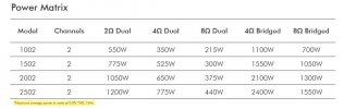

- Both power ratings (525W and 150W) refer to continuous/RMS power, right?
Here's what the ratings refer to:
ScreenHunter_192_Apr._14_16.16_original.jpg Screenshot_20240417-192315_Drive.png
