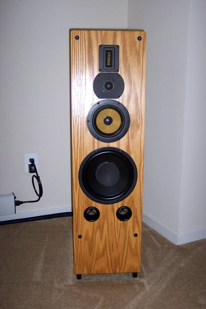

Can anyone identify this Legacy speaker?
Sven777
Dec 2, 2022
13
6
There is no model number on any of the six surfaces, but the grill does have the Legacy plate on it. I bought them used back in the 90s. Hopefully someone recognizes them and can clue me in on what the model number is.
Thanks for any help!
Thanks folks - I did find those other picture online, but I don't see any exact matches - like some of the pictures y'all posted have additional back pictures where it shows additional tweeters and/or woofers - there's nothing on the back of mine. Some of the other pictures have the legacy plate under the grill - mine does not. Anyone able to find a spot-on match?
Thanks!
Have you tried asking Legacy?
Yup, I did that a while ago, but no reply, so I thought I'd consult the community :)
I just solved the mystery - I thought that the "Reel to Real" sticker on the back was just plopped on by the audio shop that resold them back in the 90s (for marketing), but apparently Reel to Real was the name of the company before they became Legacy Audio. They are Legacy-1's. Googling for "reel to real" resulted in finding some that were a spot-on match. There are also some that look exactly like mine on ebay right now.
Thanks to everyone who helped!
They're Legacy Model 1 speakers. Just finished restoring a pair. Amazing soundstage.

Model 1
Those are the original woofers in the original post. Circa mid-1980s when Bill Dudleston was just getting started. Attached is some of the marketing materials Bill sent me when I enquired an advertisement in the back of Stereo Review. I later purchased to Legacy 2 speakers in 1990.
