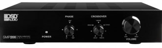

First 200w sub amp WITH crossover I thought of at $200.
OSD SMP200

Soundovo PSB-200 at $200
Looks to be the same, but rebranded
