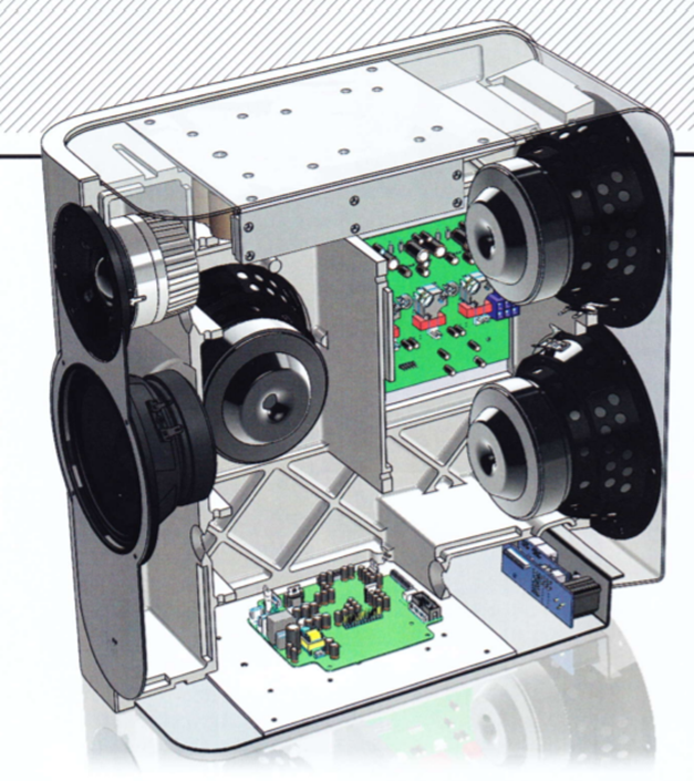

I would stick to looking at the speakers overall measurements rather than worrying about cone material which in a properly designed speaker will not matter a jot.
.... And overall kind of nonsense, considering that the Kii Three uses extraordinarily cheap drivers (outside of the customized Seas DXT tweeter)...

however i really do not understand this approach They are 15keuro speakers I would have used some of the best drivers available
Not only When a concept is very good it can be scaled up and down to get more undistorted SPL and more bandwidth usually with bigger cones
