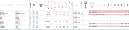

Frequency response is not really of concern for subwoofers because in the end, that'll be taken care of by EQ (which the Nubert has built-in) and what really matters is how loud it can play at a given frequency before distortion becomes audible.
This is defined by CTA-2010.
Of the subwoofers that have been measured using this standard, the most competent, "slim" subwoofer (<18cm) within your budget is the KEF T2 at 85dB SPL Peak at 20Hz/2m.
Here's a spreadsheet compiled by @sweetchaos which has all the CTA-2010 numbers and a staggering amount of other subwoofer data:
And screenshots with all slim subwoofer models in his sheet:
Screenshot_20241023-153020_Sheets.png Screenshot_20241023-152919_Sheets.png Screenshot_20241023-152813_Sheets.png
(Three screenshots required because manufacturers don't specify LxWxH in a consistent manner, so I had to filter each separately for <18cm)
If you do decide to send the Nubert off for review, then consider sending it to someone like Erin who's equipped to measure CTA-2010, as this is valuable information.
That is interesting but I'm struggling to get my head around that spreadsheet! The KEF doesn't wall mount but I could make a shelf for it.
To filter the sheet according to your needs, go to Data->Create filter view
Or do you need help with another aspect?

You picked out the best ones (T2) in the spreadsheet so that's very helpful thanks! Apart from the KEF T2 measurements I wasn't sure what you were showing me with the screenshots though.
I had a poke around with it and found Q Acoustics 3060S that seem competent and lots that had no measurements or aren't available.
