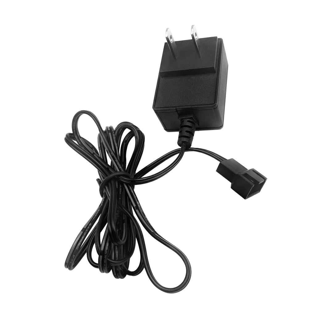

How did you power the Noctua?
I was too lazy to buy the proper cables and connectors and adapt it to one of my cheap variable dc voltage adapters accumulated over the years, so I just strip a couple of wires and hardwired the fan. It came with a low noise adapter to lower the noise to 6.7 dBA but I think it needs to use 3 wires. I just use two wires with the adapter but with the variable voltage adapter I was able to use the lowest speed that I know is food enough. 5 V should give you enough cfm and it will be near silent from even 2 ft.
If you don't have any of those old adapter, you can grab something like the following from Amazon:
Something like this would give you a plug & play solution from AC mains to a 3 or 4-pin fan:
