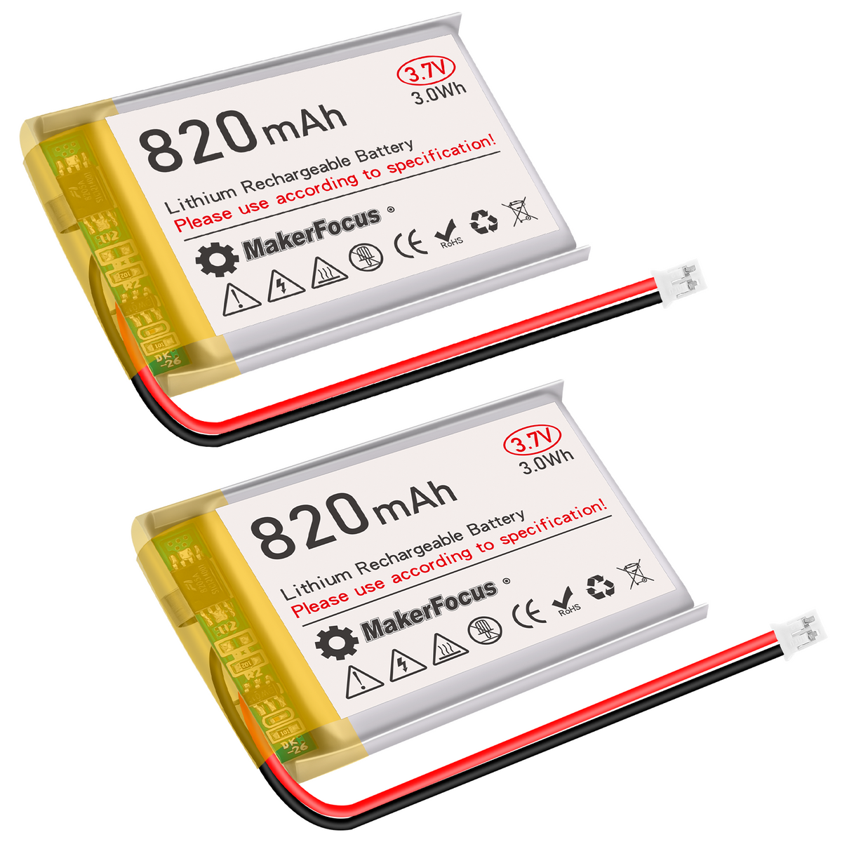

Thanks for battery life info. And glad you mentioned the replacement factor, I tried searching for replacement batteries, but couldn't find any for the X2S, only the X2. Any idea what battery it uses (I know it's a 800 mah - but not sure what kind). Do you know where you can get replacements or what the battery name / code is?
C,
I am away from home at the moment but will look tomorrow as I have bought a spare already. Will get back to you tomorrow with the code...
Can't see a code but here is a photo. Got it on Ebay...
Thanks. Looks like this one ...
42mm x 30mm -- seems to match in terms of dimensions.
Pretty sure that's it.
Looks like the model is "653042" and the connection is "JST 2.0A".
Much appreciated !!
Cheers,
C.
