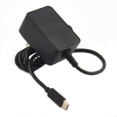

I would buy the
USB-C Power Supply, 5.1V 3.0A, Black​
You won't hear a difference in sound and it's only $8. It's an option that can be checked when buying the RPI4 at pishop.us. I am using one of these and I also have the Nirvana. I can't hear any difference in sound between them on my Revel F328 speakers and Purifi amp.
If you like to spend more money for 1 or 2 SINAD points you won't hear, then buy the Nirvana ps from Allo here:
Thanks that is a good point. I'll have to find a USB-C to USB adapter so I can keep all the cables in the back of the unit.
