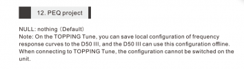

My my question regarding PEQ is: How do I configure it in a Linux system such as Moode or Volumio? If it is a set and forget process I can do either via the remote/font panel or connecting once to a Windows machine, then I can get by. If not the PEQ is useless.
The PEQ can only be configured using "Topping Tune" for Windows.
It's set and forget. The PEQ settings are stored on device:

Parametric EQ functionality (USB input only)
The EQ requires an application called "Topping Tune"
It allows configuration of parametric EQ
Apparently, you may store various configurations locally (on your computer) or on the device.
You may have up to 10 bands in each Parametric EQ configuration.
And you may store up to 5 different configs in the device.
I initially had a short test of EQ, to check if that was working when using another source than USB - it does not.
I also checked if that was working when using USB from my Android smartphone - and it does.
Now, playing more with the App, I have to say it's quite buggy at that stage (v1.02).
It happens very often that you change a setting in the app on a device config but, even if it shows the proper curve on the app display, it's not actually activated in the device !
So it's probably better to configure your EQ locally and then export it to your device.
Dang! Talk about icing on a cake. And cute too: Topping Tune.
