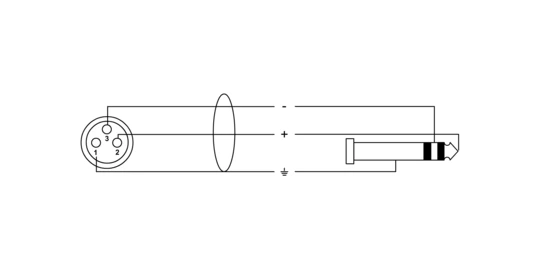

With your measurement setup you are also inviting a major ground loop. You may be able to still make this work cleanly (enough) by wiring up the left balanced output to the stereo minijack, e.g. by using an XLRf --> TRS cable and an adapter 1/4" female to 3.5 mm male. (You ultimately need 1x XLR female to 1x 3.5 mm TRS male, sold ready-made e.g. as Cordial CPM FW-BAL. (*)) You would then have to measure with the "Virtual balanced input" checkbox enabled in REW (for the input device). That basically subtracts one channel from the other, forming a poor man's balanced input. Input level handling should increase by 6 dB, but the same goes for balanced vs. unbalanced output level on the DAC, so it's ultimately a wash. Input noise / dynamic range should effectively improve by 3 dB though.
https://www.cordial-cables.com/cable-assignments/image-thumb__640__product-detail/terminaldiagram-fw-bal.webp
