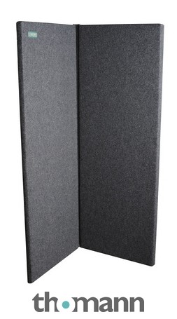

Clearsonic S2466x2 Sorber
Two-Section Absorber Panel Made of compressed fibreglass and encased in dark gray cloth, Both panels are joined together with a fabric tape and can be used freestanding, The panel can also be mounted on the inside of the acrylic ClearSonic shields...
