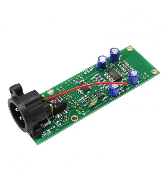

Next possible solution could be HDMI multichannel extractor to 4 x I2S and 4 x I2S to AES/EBU interface.
Than you can use direct connection via AES/EBU to the okto dac8 PRO.
HDMI multichannel to I2S extractor:
I2S to AES/EBU interface (4x)>
Or
I know, it is more DIY but for EE should be not problem. ;)
I did not made such interface before, but generally should work.
