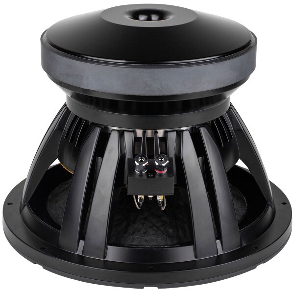

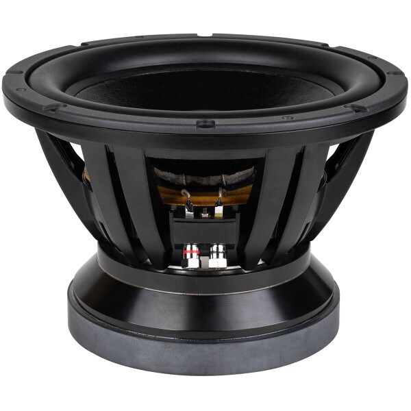

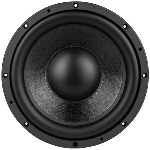

How about in a .9 cu ft box using 12dB of lf boost between 20 and 80 Hz? That should be very close to flat, and the woofer is stupidly powerful.
By LF boost I mean a lowpass network down 3dB at 20Hz and 12 down at 80Hz.
