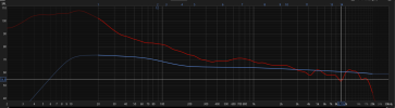

Hi everyone,
I’m relatively new to the HiFi world but have been learning the basics of REW (Room EQ Wizard) and feel reasonably comfortable with it. Today, I decided to try measuring a new pair of headphones (Sony Ultimate Wear) to better understand their performance.
However, I’m questioning whether my measurement results can even be correct. Here’s what I’ve done so far:
  • All EQ settings are turned off.
  • I tested both with and without ANC, and it doesn’t seem to make a big difference.
  • I used a UMIK-K1 microphone and ensured the ear cups were properly sealed during the measurement.
  • I also used the 0° calibration file for the microphone.
Am I possibly doing something wrong in my setup, or could these results be accurate?
Also, does anyone have a recommendation for a good EQ app for mobile phones that supports a fully configurable equalizer?
Any insights or advice would be greatly appreciated!
Thanks in advance!

What is your measurement rig exactly? I'm assuming you've made a flat plate coupler but you haven't explained.
There is no "correct" with DIY measurements as there's no standard. Having a very well known benchmark with low unit variation like a HD600/650 helps (this is what I do).
That said, I don't know this headphone but a slope down from 20Hz to 20kHz seems like the sort of measurement you might get with a flat plate coupler.
Okay, maybe this is where the issue lies.
I simply pressed the ear cups together with the mic in the middle until they sealed.
But didnt used a Flat plate coupler.
Would it make sense to use some sort of an "artificial head" for these measurements? Or is there a somewhat cost-effective way to achieve similar results?
OMG.

The FR is a disaster. Harman's OE2018 target is already a bit bassy for me, and 10 dB more bass while the highs are equally lacking is a definite no-go. And if you use EQ, why then choose this particular model?
Useable headphone measurement rigs with KB500X clone pinnae and ra0045 clone couplers start from around $500-1000 and can be bought on AliExpress.
Cheaper setups (e.g. miniDSP EARS) can still be used to measure relative frequency response differences, like between headphone A and headphone B, or between Left and Right (channel balance), but they're not useful for judging frequency response neutrality because they do not sufficiently emulate the geometry and acoustical impedance of the human ear.

Ah yes you are essentially creating a seal against the open cavity of the corresponding cup in that case. If you are also measuring both channels at once who knows what strange effect this will have.
It depends what you want to achieve: I don't think making a flat plate coupler is useful unless you have lots of headphones to measure, including some well known reference models like HD600/650.
On the other hand, it can be as simple as getting a roughly head sized box and cutting a hole for the mic.

I would ask Solderdude from DIYaudioheaven, who often posts here on ASR. He uses flat baffle for measurements and specific correction curve. MiniDSP EARS is not that great and accurate especially compared to GRAS professional headphone measuring gear.

Learned, that there are no roomacoustics for Headphones. So i can just take any measurement from the Internet taken with a proper setup.
