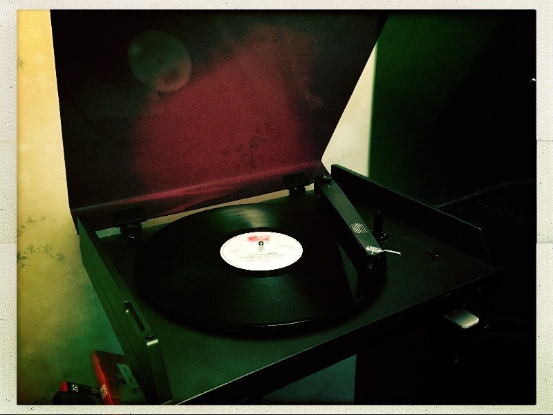

Later on I got my own little travel vinyl player in red plastic and my own first single that wasn't a kids' record was something I'd heard at the neighbour kid's (10 years my senior) place: Sweet - Fox on the run

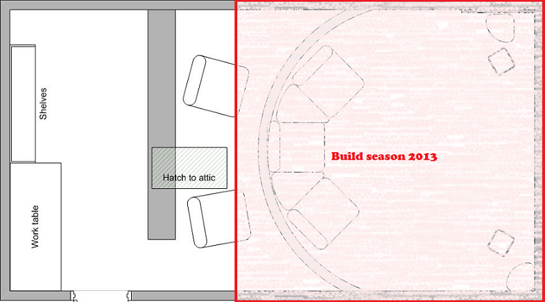

The basic floorplan for what was doing was like this:
The inner dimensions was 14 2/3 by 26 2/3 feet in total, but it's been decided/designed to just use 18 feet for the cinema and the rest for a sound-dampening back wall and storage/machinist room. Later changes to soundproofing would steal some of those dimensions.

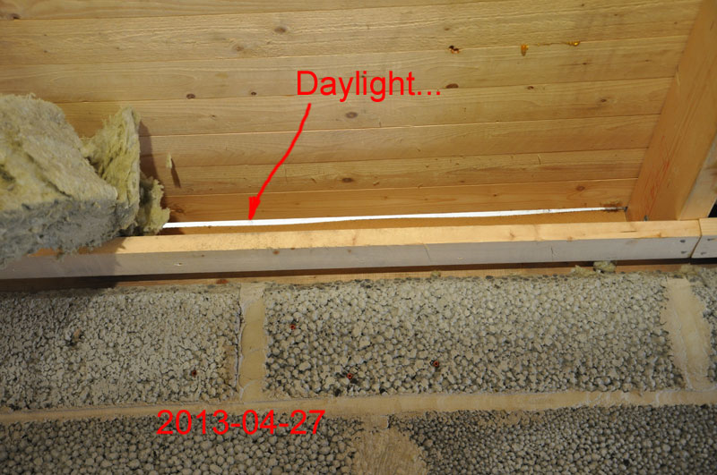

Starting the teardown now that the winter have broken - don't want to chill down the house too much.
Will be a run against the clock to get it insulated again before next winter, so only doing half at a time:
Besides the expanded clay blocks themselves, another apparent issue:

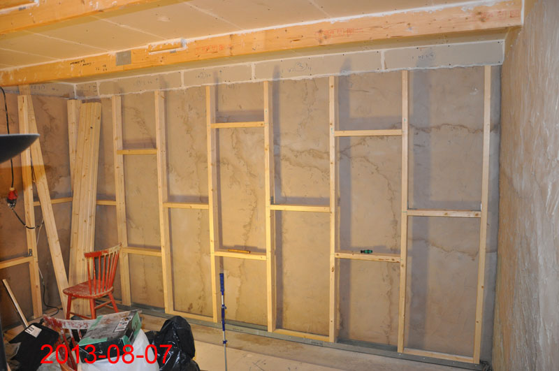

All the parging done for now, starting to erect the new, free standing inner walls.
The first new ceiling beams going up at the end of the month (glulam to keep dimensions down):

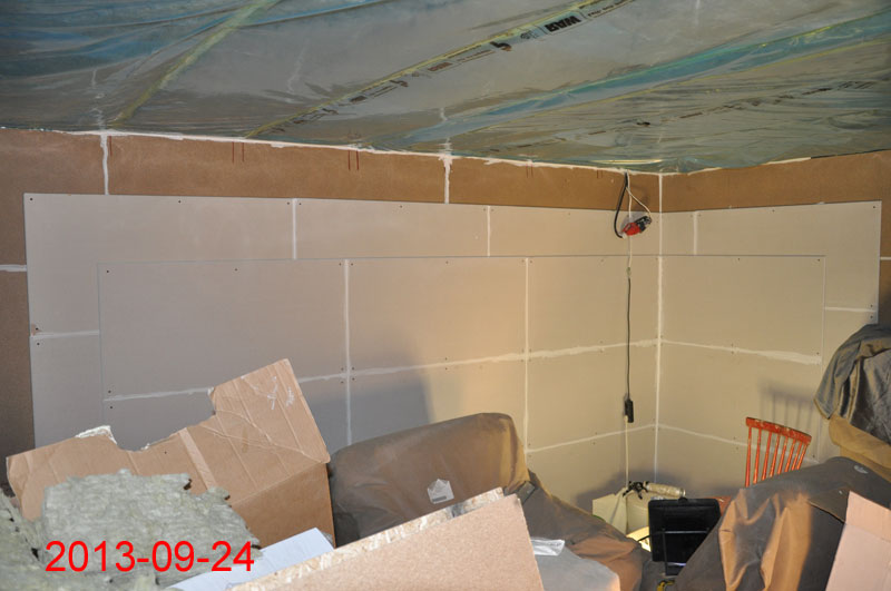

New inner walls coming up now. One layer of floor board and two layers of drywall with green glue inbetween. Wasn't sure if that really had an effect, but did not care to end up with a new build that still wasn't soundproofed and then thinking to myself "what if I had used green glue?", so it had to be.

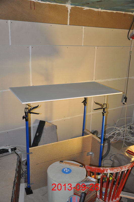

Building my own drywall lift instead of renting one:

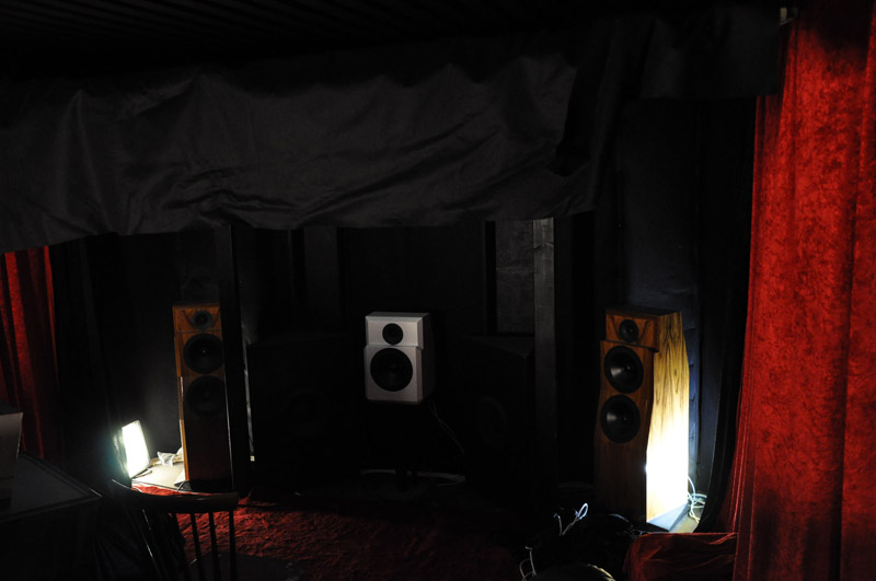

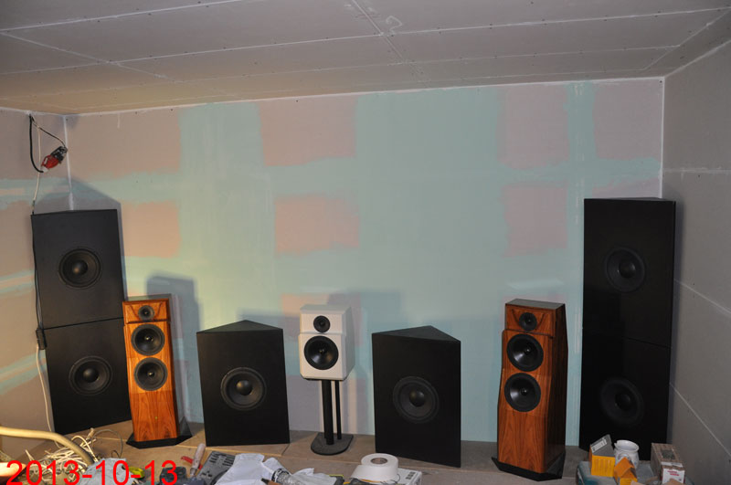

Walls and ceiling done and speakers brought forth to pose. Did some testing to hear from the outside what effect the partial build had had.

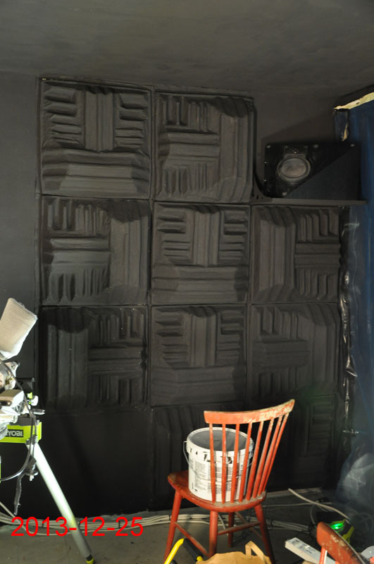

Painting walls and ceiling and building diffusers over winter "break"... yeah also on a day like this one...

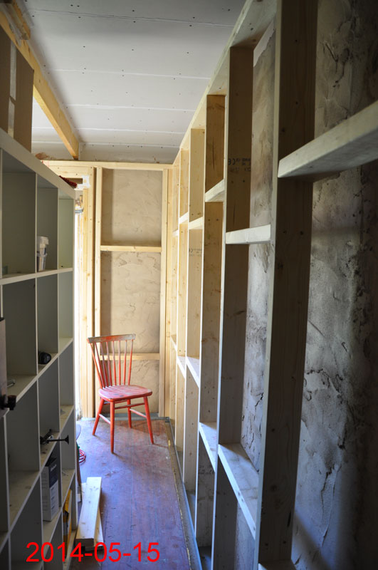

[Mid May 2014]
Inner wall done here too and drywall on the bottom of next floor up

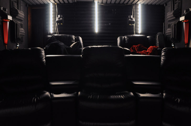

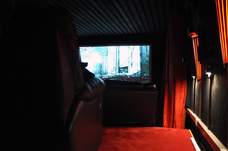

Diffusion on the ceiling, wall diffusers upp and painted, surround speakers back up, carpet put in and drapes hung. Daughter with two friends get sneak premier#2 on part one of the Lord of the Rings (Extended).
[September 2014]

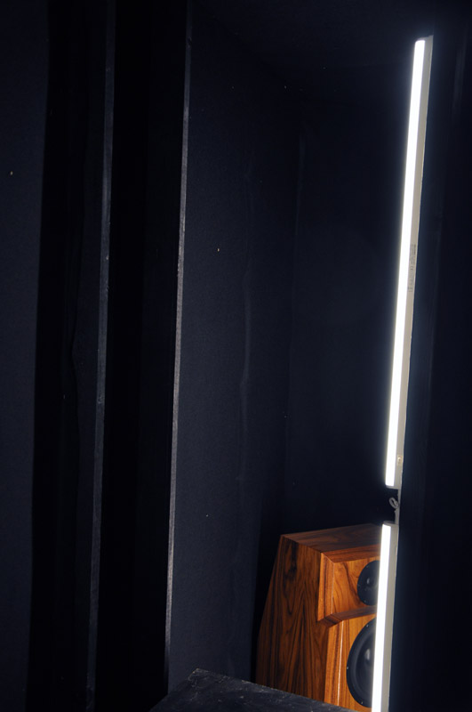

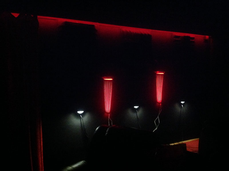

Some work being done with mood lighting, red lamps DIYed with LED-tape, being just white in original.
also a quick and dirty sweep (both channels running, so some unnecessary comb-filtering seen)

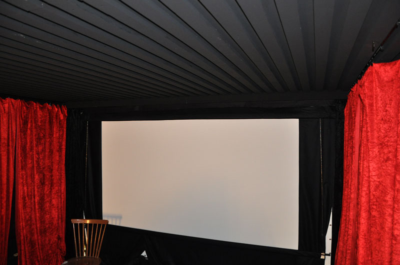

Built myself a frame for it - used aluminum profiles to get the weight down so it could be folded up towards the ceiling when need arises.

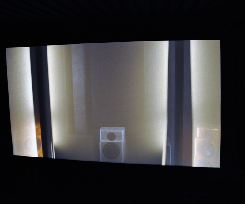

After watching Interstellar I went another round with the calibration... and it ended with the odd result that the DSPeaker DualMode 2.0 went out of the system totally, from the simple reason that it was effecting signal quality even in such a simple use case as being in "off" position. Given the lift I have in the cr80es filter, there was no option of using it that late in the chain. Possibly I can use it in the tv room where there is a more suitable situation to try that.

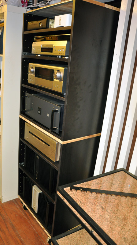

Old equipment stand started getting too heavy to pull in and out when changing something, so I deceided to build my own rack on wheels based on an IKEA kitchen cabinet.
Quite pleased and I added five silent running Noctua fans with fan control later on to make it even better.

Made some simple masking for the screen (16:9 format)
Some visualization being done as well in parallell with the build to make sure I was thinking right:

[Mid May 2014]
[September 2014]

Screen fabric picked up - total driving distance 550 kilometers. Still way cheaper than importing one from Seymour.
[April 2015]
Tip: never thing "it cannot make much difference"... It do!
