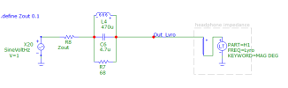

The impedance plot suggests a resonance at 1.5kHz but it is just barely visible in the FR and not so much in CSD.
Easy to use on higher output impedance sources. The bass level would still vary depending on the setting but as that is always done by ear it does not matter.

I'll try your proposed circuit when I'm back in the lab!
If only they would have gotten rid of that 3.5kHz peak then it would not have desperately needed EQ.
Oh wait.... there would be an easy fix for that.
Before I get to soldering, I ran a simulation to see the effect on the frequency response:
This shows the voltage going into the headphone (the LT-macro has the same impedance as the headphone, I can feed it directly with measurement results, so I don't need to simulate the headphone as a resistor but can take its actual complex impedance)
Reading the voltage and multiplying it with the measured voltage sensitivity of the headphone gives me this (simulated) result:
A bit of overcompensation at 3.5k.
Cutting the resistor in half (to 34 Ω) gives us something that's pretty spot on though:
This is with the bass knob set to the middle position (notch 4/7).
I have to say, this looks promising. Time to get to soldering I think!
