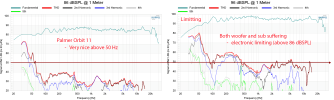

Stoneeh's IMD measurement of the Orbits for 100dB rms. Don't know for sure how comparable this is. KH test signal seems to start at 50Hz while the lowest frequency for the Orbit measurement is about 55Hz. Levels are reasonably close. Biggest question is how the Monkey Forest measurement system analyzes distortion components. Does it track peaks witin the analysis bands or rather some kind of average or rms value (like the red line in the ARTA plot). In both cases the Orbits seem to score quite well.
For real fullrange use, the test signal should start at 30Hz. This would make the KH150 look even worse.

IMD
IMD measurements for Neumann speakers were shown in post #6 and for Orbit 11 in post #7. Conclusion for Neumann measurements was that KH310 has lower IMD in the midrange than KH150. This is to be expected as KH150 is 2-way only. For Orbit 11 measurement it's not entirely clear if it can be compared directly to the Neumann measurements as it was generated by another measurement SW. However, the Orbits IMD plot is very clean with closest distortion peak at about 120Hz/-30dB. Neumann plots are only -22dB over a wide frequency range.
The 100dB SPL Orbit measurement and the 98dB SPL KH150 measurement show a single combined value for TD+N (total distortion + noise).
These are listed below as relative dB value and % value (one can be calculated from the other). Again, looks better for the Orbit.
TD+N from IMD KH150: -22dB/7.94%
TD+N from IMDOrbit 11: -35.5dB/1.68%
Max SPL limited by THD
Data below taken from Sound&Recording measurements of the Neumann speakers and stoneeh measurements of the Orbit 11.
Unfortunately frequency ranges and THD limit did not match well between those measurements (check legend entries!!!).
Nevertheless, the combination of available data gives some insights.
Available data:
For KH150 max SPL data at 10% THD is available for 38-10kHz
For KH310 max SPL data at 10% THD is available for 70-300Hz and max SPL data at 3% THD for 70-10kHz
For Orbit 11 max SPL data at 10% THD is available for 30-68Hz and max SPL data at 1% THD for 100-10kHz
Additionally a THD plot measured at 106dB SPL was analyzed for the Orbit 11 and SPL plotted for all frequencies that showed <10%THD (basically above 65Hz)
Insights:
1. For max SPL at 10% THD, KH150 has slightly higher output than Orbit 11 from 40-60Hz.
Below and above this frequency range, Orbit 11 has higher output up to >1kHz (no comparable data above that).
2. For max SPL at 10% THD, KH310 has lower or similar output compared to the Orbits at 70-300Hz (no data below that for KH310).
3. In the midrange KH310 and Orbit 11 show clearly higher maximum SPL than KH150 (despite lower THD limits).
4. From 600-1.2kHz the max SPL at 1% THD from the Orbits gets very close to the 3% THD plot of the KH310.
5. From 500-1.5kHz the Orbit's max SPL at 1% THD is higher than KH150 at 10% THD
Conclusion:
THD and IMD data available for KH150/310 and Orbit 11 was analyzed for high/max SPL levels.
Contrary to common believe, absolutely no superiority was found for the Neumann speakers.
Due to expected cleaner midrange KH310 would be preferable over KH150.
Orbit measurements suggest midrange performance closer to KH310 than KH150.
For 86dB SPL the Orbits are basically fullrange while KH310 is close and KH150 misses low-end extension.
For clean bass at high SPL all 3 speakers require a subwoofer.

This would give the KH750 a 6dB advantage over a pair of Orbits with relatively clean bass.
Note that I do consider 10% THD clean for low bass. And I question the use of ultra low THD subwoofers for mixing.
This would translate poorly to most normal speakers which often produce much higher THD than 10%.
From this little analysis you should understand that a pair of Orbits will get close to a single KH750 when it comes to maximum bass output.
A 6dB advantage, based on manufacturer specs, is still an advantage but it will not be as high as you might have thought.
As I have a pair of Orbits, I can report that their bass makes a few things shake in my room which is quite a bit larger than your room.
As you are coming from HS7, the Orbits will be a really huge improvement over your current setup.
And you may find that you don't require a sub at all as your expectations may actually not be very high considering where you come from.
In case you still want a sub, you will have quite some money left compared to Neumann/Genelec setups.
In addition, cardioid + coaxial dispersion characteristics of the Orbits can help to reduce reflections from your table.
In your setup, table reflections will be the worst and vertical dispersion becomes an important factor.
Only large Genelecs like 8361A come close to the vertical disperson control of the Orbits.
Palmer gives you 5 years warranty. And with their low price you could simply buy and sell another pair to avoid any delay in case of defects.
So if you don't need big name speakers, the Orbits are a very good alternative.
Left: KH 750 DSP/AES67 Harmonic Distortion at 95 dB SPL in 1 m (Blue: THD, Green: 2nd harmonic, Red: 3rd harmonic)​
Right: KH 750 DSP/AES67 Maximum SPL at 1m (Red: 10% THD, Green: 3% THD, Blue: 1% THD)​
