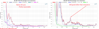

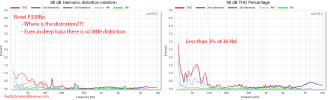

What do you mean now? When Amir measures to loudspeakers he reports THD , 2nd,3nd,4nd,5nd Harmonics. Two speakers as an example of that:
Revel F328Be Relative THD Distortion Speaker Measurements.pngTekton Design’s M-Lore Mini Speaker Distortion Relative THD Measurement.png
Then speakers can have a very uneven FR while having very low distortion (some electrostatic loudspeaker (ESL)) or vice versa (although this is not that common).
