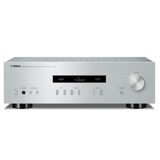

More for 'us' maybe as I suggested, an A-S201 *amplifier* for the same UK price. Looks like 4mm speaker sockets, PHONO STAGE and it looks as if the amp circuit isn't so different from this one (layout is slightly different though). Claimed power output is at 4 ohms and 0.7% distortion and they quote the old fashiond peak (music power) output too (I still prefer the 8 ohm rating as well and maybe 0.1%), but I put it at a perfectly adequate 70WPC at 8 ohms and it looks as if it's not fazed by 2 ohms either.
