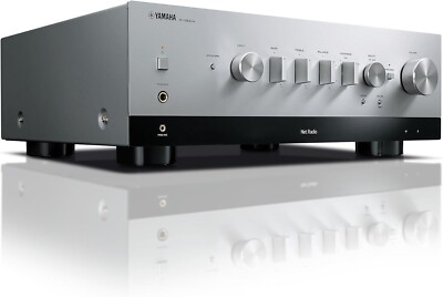

Just to give you an update to you all. I first bought the R-N803 and had it for 6 months. It was all good except it cannot play high bit rate DSD files and a few other Hi-Res files from my NAS (Natively does not support those bit rate files and formats). Also it was unable to play a few formats like APE which I had a collection of audiophile tracks and test tracks. This was the case with any other streamers I have tried in the past including Cambridge Audio, WiiM etc. Also, I was using the Topping D10 as the USB receiver and Coax Digital to the R-N803 for all my iPad contents including Apple Music Lossless.
I switched to the R-N800A a few months back and I'm very happy about the switch. Firstly, this thing can play every single file format and bit rates possibly available. Yes, all my file collection can play now. Also, I can connect my iPad directly to the USB input in R-N800A eliminating a conversion device in the middle. As far as sound goes, both R-N803 and R-N800A are similar. I'm even hearing some better details from R-N800A. Only gripe is I was able to pair the R-N803 with my AV Receiver RX-V6A for multi room audio. But that now seems to not work from the app. May be some of the components or app needs an update need to spend some time on it.
I bought my R-N800A open box from this seller and it was in brand new condition for a good price. Looks like they still have some units if you are looking for some.
@Bumer reason for R-N803 not being able to pay DSD is pretty basic TI (BurrBrown) DAC it has dosent support it. I never heard that for APE, even old R-N402D could do both (BurrBrown DAC with DSD front end). You really shouldn't had to do literally almost same post 7x across the board.
