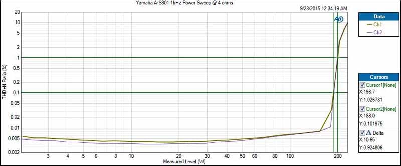

A-S801:
199W.
Relative to the Yamaha at 100% loudness, the Vibelink can play 89% as loud and the Amp Pro 85%.
The Yamaha's dynamic power and capability to drive challenging speakers greatly exceed those of the Vibelink.
Notice that the Vibelink is only tested with 1 channel. The values below would probably not reflect its power output with two channels driven.
