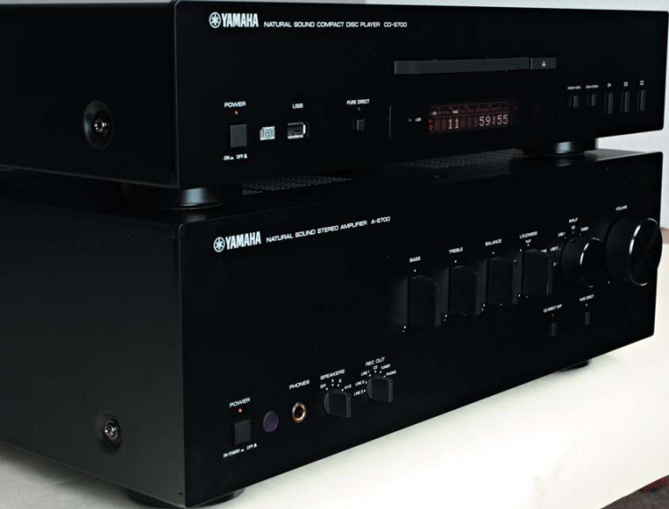

I think I saw it in some of the tests of Yamaha gear in Polish Audio magazine, but now I only managed to find measurements of the A-S700 that were done with both Direct features engaged and not engaged.
“The signal-to-noise ratio is 90 dB, the dynamic range is 111 dB, but by not engaging both Direct modes, we will get results that are 4 dB worse.”
I’m sure there are measurable differences between the modes in A-S701 just as well. Only question is how they translate into anything that could be described as potentially audible. From your responses I get it is unlikely that I will hear any differences, which is a good news to me since I have more than one source that I would like to plug into the line inputs on my new A-S701.
If the sound was indeed worse using those line inputs rather than CD direct, then I would only use my WiiM Ultra as a digital hub for my other sources (Yamaha CD-S303, Oppo BDP-105D and TV) and I would plug the WiiM into CD input on the 701 with both Direct modes engaged.
According to the Block Diagram of the A-S701 service manual, Pure Direct bypassses the tone controls. CD Direct converts the unbalanced CD input signal to balanced and passes it to the the volume control of Rohm BD3473KS2 (bypassing tone control and loudness) and converts it back to balanced before passing it to the 29db gain main amp (red: CD direct, green: Pure Direct):
Both improve the SNR, CD Direct even more, according to spec in the service manual:

Yamaha is using this type of bypassing since decades. My experience with that is the residual noise is reduced which could become audible with high sensitivy speakers or nearfield listening. The already rather low hiss is further reduced.
