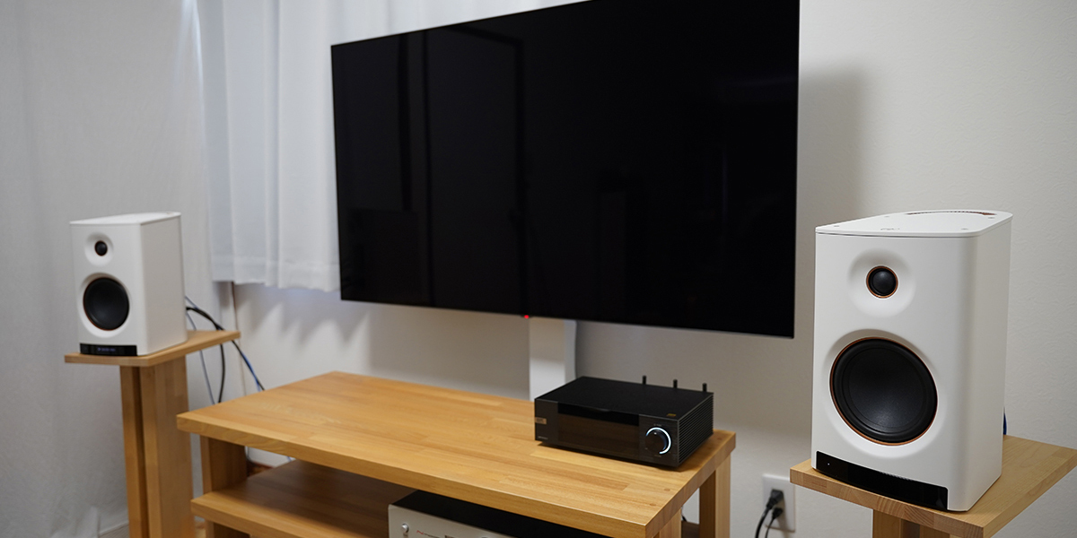

Would you consider an all-in-one active speaker system if the engineering is done right?

The brief architecture of the device is, the streamer feeds the I2S signal directly into pcm-to-pwm Class-D amp that integrates DSP function inside, so as to separately drive the loudspeaker units without any DAC precess involed. The advantages r quite appealing to me, first of all, all modulation logic runs in digital logic gates, there are no analog-comparator-generated analog signals throughout the whole process, it’s simplified and better noise-free, perhaps can reduce the malfunctioning chances, and the BOM cost would be lower as well.

I aim to elevate the system integration level toward an all‑in‑one form factor. On one hand, active‑system hardware together with DSP grants me higher‑dimensional freedom for acoustic tuning. On the other hand, I intend to achieve full decoupling between electronic circuit boards and the speaker enclosure. That said, this cannot be fully explained in a few words. Feel free to dive deeper into this topic if you are interested.

What I aim to achieve is more serious‑grade acoustic results, not oriented toward lifestyle aesthetics, but rather tailored for enthusiasts and people with high demands for acoustic performance. Unlike many past products, the goal of high integration is to eliminate unnecessary processing stages. One example is a purely‑digital signal‑chain system design: digital sources feed digital signals into the DSP. After DSP processing, I²S digital signals are fed into a PCM‑to‑PWM Class‑D amplifier module for direct digital‑modulated amplification. No analog signals are involved throughout this process. This effectively removes ADC and DAC stages, bringing down costs while improving performance.
Regarding the commonly‑cited concerns over maintenance and upgradability, my approach is to decouple the electronic boards from the speaker enclosure, forming independent design closed‑loops for these two major assemblies, and building the system around these as the largest integrated units. Under this scheme, users receive a purely passive loudspeaker without a crossover, alongside a separate box housing all software and active components. All user‑side maintenance and upgrades can be performed solely on this box, with no need to replace speaker drivers, directivity‑control waveguides, or the speaker enclosure itself.
